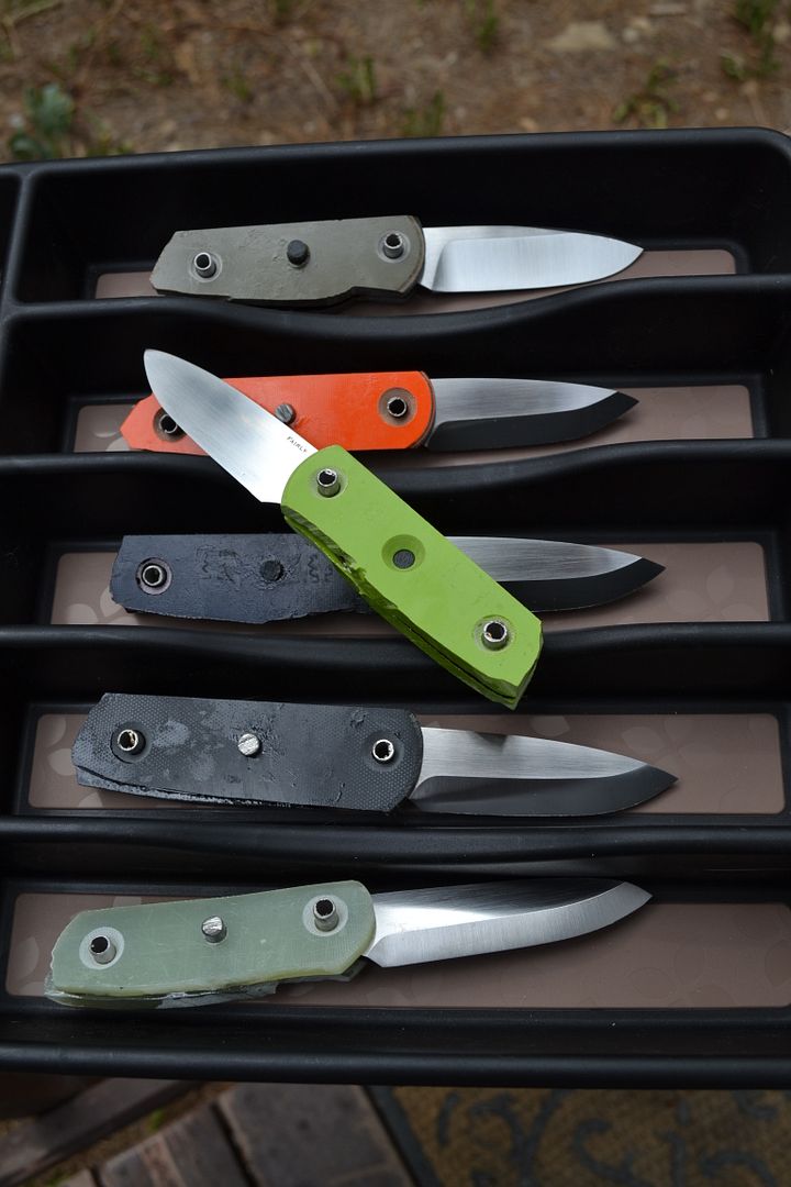

These are made from Aldo's legendary 1084fg steel!
Here's some random info...
.140" 1084fg tempered to 60-61 RC for great edge holding, toughness and ease of sharpening
Chisel grind! great for woodwork or general use... these are all Scandi grind as well (besides the top one)
G10 scales
Micarta or Titanium center pins
Flared stainless steel tube for the best of looks and toughness
Available soon!
Grinding the scales is next...

G10 lineup!
MCAM 3 Color Camo
Orange/Black layers
Neon Green
Black/Dark Red
Black
Jade

These will be available soon! I'm going to contact someone who ordered some a ways back an go from there.

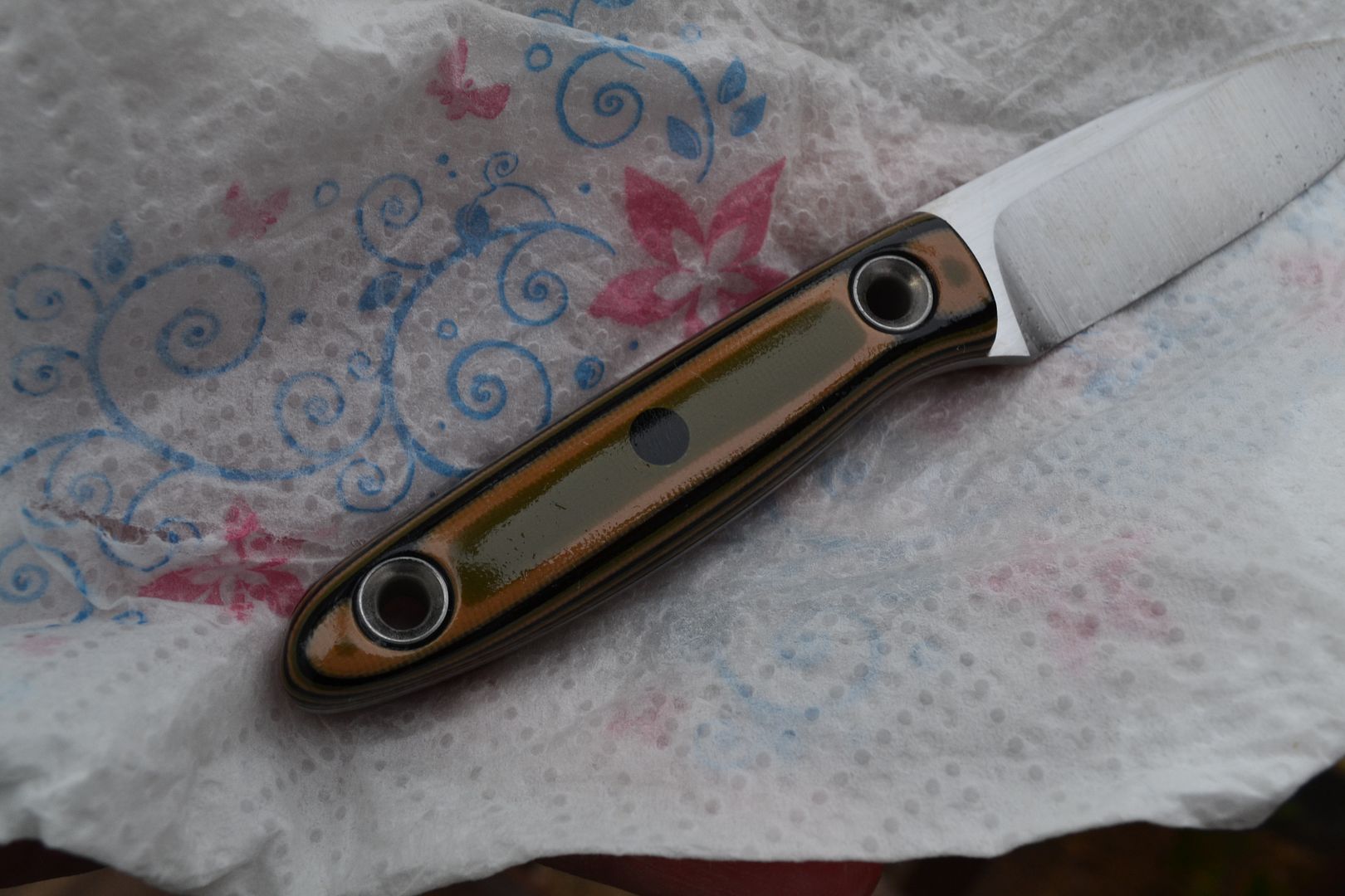

This is the one with the different grind...
I just did a ton of hand sanding on the scales and soaked the knife in food grade mineral oil, it needs to be sharpened and will be ready to go!
The tubes are satin polished on the inside, it took a while but I think it looks cool. I'm very happy with the black micarta rod too... to me it sets off the MCAM!

Do you flare out the tubes to act as a rivet? Or Do you use epoxy as well as flare them out?
Yes that is correct, tube as a rivet and everything gets epoxied.
I like a mechanical bond on top of the chemical bond, it makes for a strong handle. The handle also has small holes drilled through the tang which get filled with epoxy and act as "glue rivets."
