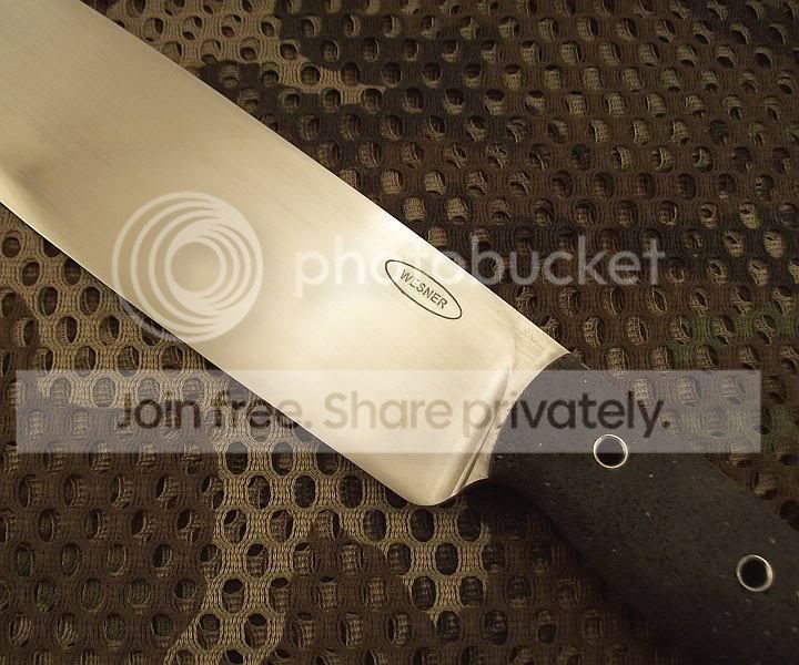

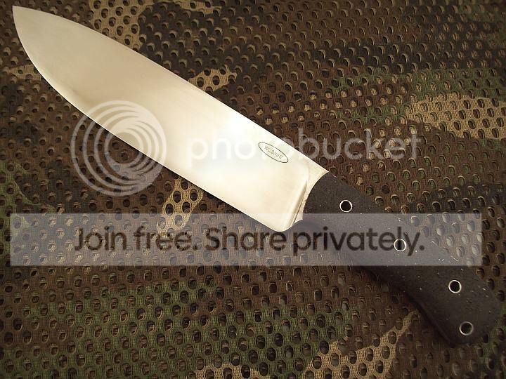

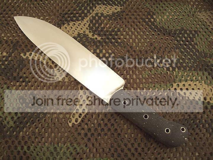

FWIW, Here's a couple pictures of the Chopper I just forged using Horse Stall Mat for handle scales.
Just for the record, I used Loctite 326 on the steel and the activator on the scales. You couldn't get them off now if you tried, not without destroying them. They're stuck for good !

Some tips in regards to how I worked the Horse Stall Mat .......... after glue-up I roughed in the shape using a 36 grit 3M 967 Cubitron belt, then moved to an 80 grit belt of the same type.
From there I went to 120 grit then 220 grit Klingspor J-Flex, the yellow belts. I found sharp, brand spanking new belts worked best.
220 grit belt finish is as far as I went and what you see in the pictures.
