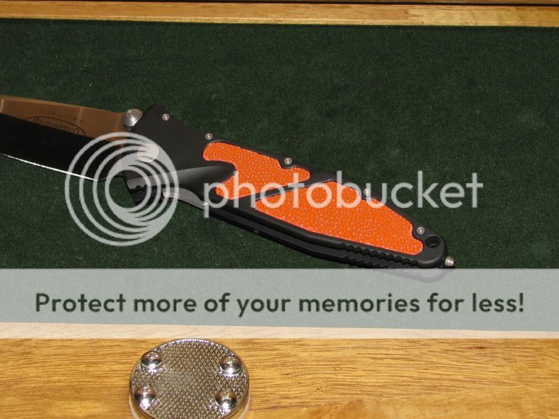

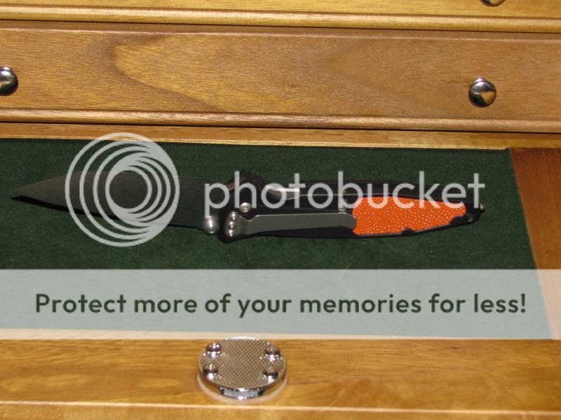

Thanks for the tips. I will try those next time. My next project will be a Blur. I got home from work early so the two front inserts are glued and clamped right now. I will do the last/rear insert in a couple hours and might be able to get it put back together tonight.
Well, here it is. I'll admit it isn't perfect but the pics make it look worse than it is. You can't see any trace of the glue in person. I'm going to order another piece of skin and maybe try again. Maybe try on some other knives.
