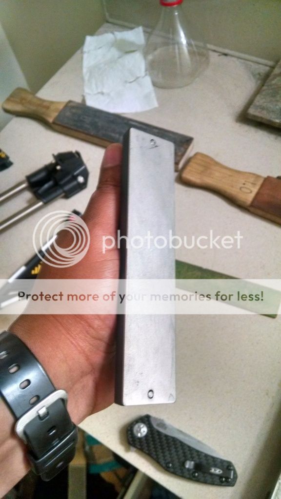

The most cost effective, muti use sharpening system.
Ill probably toss the angle guilds. I also don't use the "pivot response"
Would have been fun to learn on when I started sharpening though.

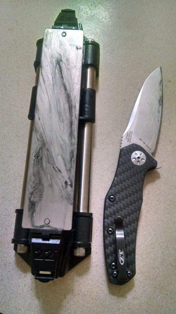

I'm a busy guy. Sharpening can be time consuming, diamonds shred Elmax fast. This is the 800 grit stone with water. Brought a burr to each side in no time. I sharpen in a back an forth motion.
Cut the burr off with edge trailing strokes. Thanks Heavy, learned a ton from your posts and vids.

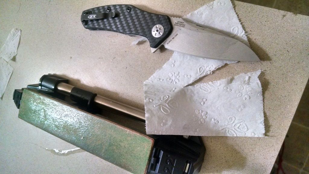

It could shave but not effortlessly
Honed on the white ceramic.
Stroped on leather with provided green compound.
Can cut toliet paper unsupported and shave facial hair.

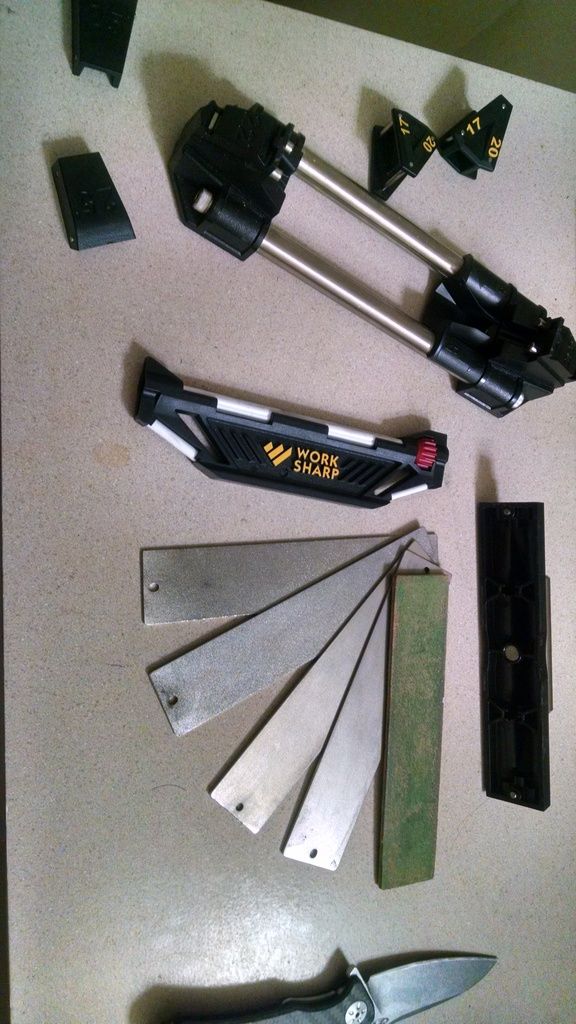

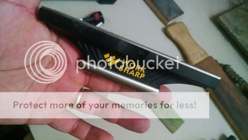

The device is really slick. I love how it can be used without the base like a hand stone in the field.
Best so far, especially for the cash. Under a c-note.

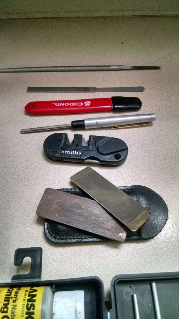

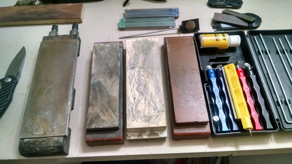

Here's the sharpening stash.
The waterstones leave the best finish but take longer for setup, clean up and cutting.
Angle guided sharpening just takes too long all together. I have bad, bad ADHD.

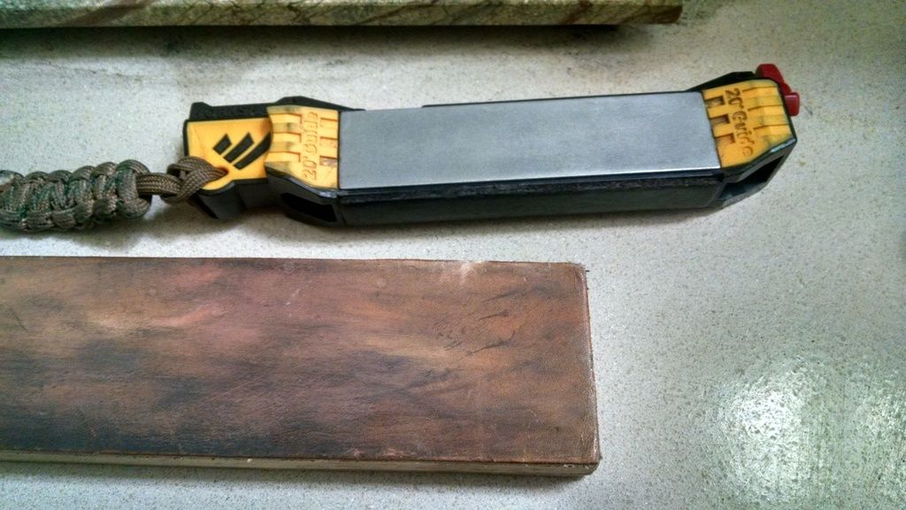

Some minimalistic field sharpens. I have trouble producing the same results with. Love my DC3 to pieces hahaha.
My field sharpening work horse. Best on the market and only $30. Just wish there was a more EDC friendly one.
