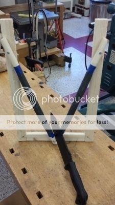

I currently use DMT stones and a DMT Aligner system for reprofiling and repairing edges. I use a Spyderco Sharpmaker and homemade strop for maintaining edges.
For my large blades, I built this over-sized 13"x18" cross-stick sharpener. Keeps my 9" BK9 razor sharp using just sandpaper.
