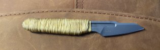

Anyway, this morning I did a few tests using XRF. Calibration with these units is really more of a verification that a unit is operating as intended rather than calibration that might be done with other equipment. They are pretty reliable, close enough in most situations, albeit imperfect. I'm using an Olympus Vanta, performing multiple tests, and testing known reference standards. Admittedly, I don't have any known standards on hand at the moment with Vanadium concentrations as high as in most of the alloys tested. My suspicion is that this unit is currently reading Vanadium a little bit on the low side, but I will have to do some further investigation there.
Today I tested a S90V Hectare from CJRB, a D2 Scuttler from Kizer, and a Magnacut Esker M from Boatright Bladeworks. They're just what I had on me. Limited elements listed, I'll spruce up the format and try to get some established ranges next time. For now, you'll have to refer to u/Larrin Knife Steels Rated by a Metallurgist article.
Steel-KnifeC (%)Cr (%)+/- Mo (%)+/- V (%)+/- W (%)+/- Co (%)+/- Nb (%)+/- Ni (%)+/- Other
S90V - CJRB Hectare NANA14.62.281.031.0268.30.33.193.055NANA.037.005.243.068
D2 - Scuttler KizerNANA11.91.15.89.015.523.060.025.022NANA.167.006.247.051
Magnacut - Esker M Boatright BladeworksNANA10.72.232.080.0373.79.22.099.046NANA2.42.037.202.065
Nothing from the results really stands out to me other than the Vanadium readings being slightly low, possibly due to equipment. That discrepancy is most evident in the Scuttler, but again nothing flag raising. Everything else seems to be in line with the compositions posted in the linked article.

Round 2, same deal, running a couple tests for fun. I'll still get to putting something more formal together or reach out to the other person mentioned doing similar things.
I pulled out a different analyzer to see if there was a noticeable difference in the Vanadium concentration, but the only knife from yesterday I had was the D2 Scuttler (it lives in a little pouch I move from bag to bag). Results were very similar. I believe 1.10% is a maximum on the Vanadium and I'm not sure that a minimum is defined, though it might be in some code applications. Separate note, I want to ask some metallurgists about performance variations in a given material on different ends of acceptable ranges for given elements. In the fabrication world I run into a lot of materials testing out at the very low end of acceptable ranges on alloying elements. My assumption is that is because most of those cost more money than iron, but I'm curious what that means for performance.
The other two knives I chose for today have the same steels. I have a S90V Eddy 2 from Wachtman Knife and Tool and a Magnacut M1 Pro Backpacker from White River Knives.
Steel-KnifeC (%)Cr (%)+/-Mo (%)+/-V (%)+/-W (%)+/-Co (%)+/-Nb (%)+/-Ni (%)+/-Other
S90V - Eddy 2 WKTNANA14.05.151.07.027.70.13ND<.07NANA.030.004.12.04
D2 - Scuttler Kizer -BNANA11.35.13.92.02.51.04ND<.06NANA.154.007.20.05
Magnacut - M1 WRKNANA10.58.132.13.033.67.09.14.03NANA2.31.03.14.04
I really need to figure out what the range is for Vanadium in S90V. I might have to pull of the scales on the Eddy 2 and the M1 and hit them with the OES to see if I get significantly different results, but I have decided if I'm keeping this one or not. When I decide to start pulling scales, I will go ahead and do some hardness testing as well.
Overall, results are pretty similar. The Scuttler control makes me feel a little more confident. Magnacut appears to be pretty dialed in on composition, but again would love to know ranges. More digging. Thanks for looking, this is a really nice distraction for me right now.

From my perspective, I am not really too concerned about variances with in steel chemistry or knife companies misrepresenting the steel that they are using. I think the main concern that most people have is with the heat treatment and the subsequent aging from post heat treatment grinding or coating application.
So, to me, hardness testing is the only non-destructive testing that I am particularly interested in. Of particular interest are micro hardness profiles near the edge, like this one:
