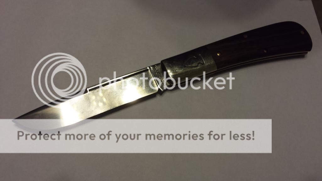

I got a Northwoods Madison Barlow in the mail today. I was impressed by the finish when i took it out of the box. The knife is ALMOST flawless but there is one big that bothers me.

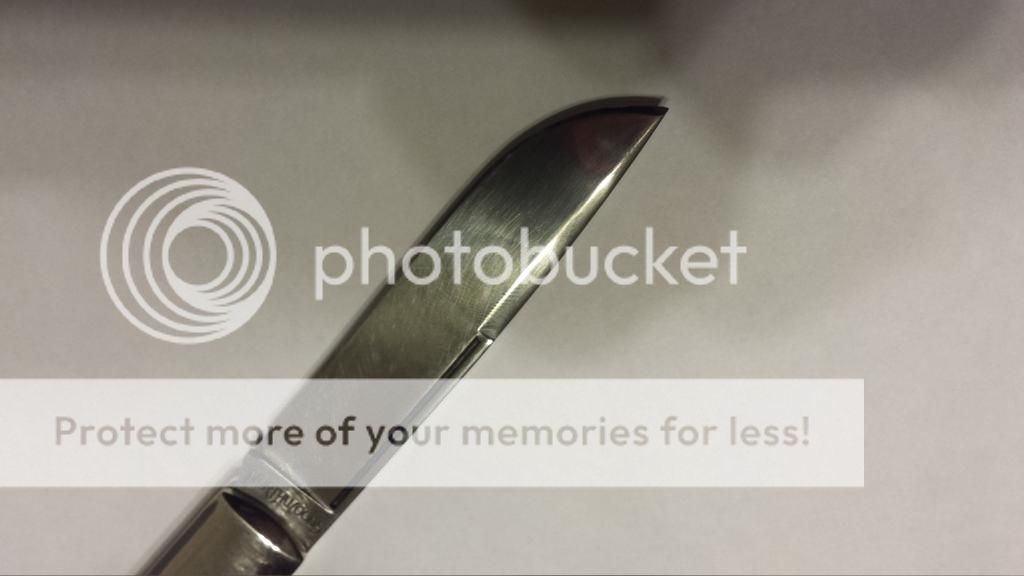

The edge hits the the inside of the backspring! Yea, sure, I it will go away as the blade wears down over time. But it is a new knife. I expected better from GEC, who made them for Northwoods.
I do not know if the flat spot can be seen, but it is there (sorry for low quality pictures)

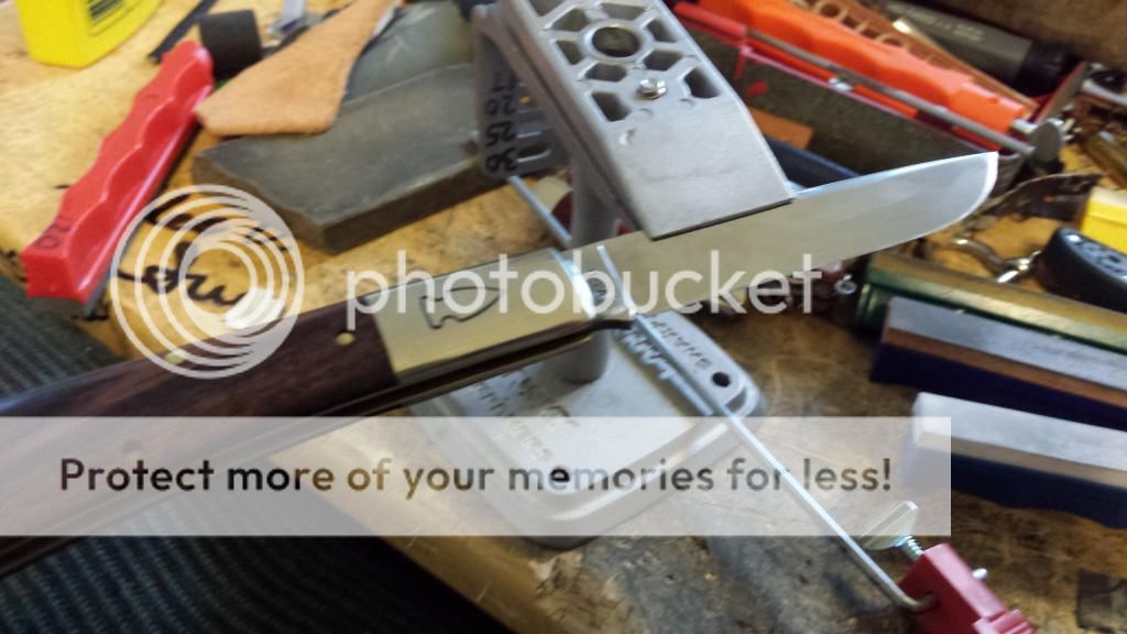

Here it is on the lansky while i was sharpening it. i sharpened the flat spot out but the first time i closed it, it hit the backspring again and did the same thing.

Its a known problem with the drop points because it sits so low. Besides removing metal from the blade, you could put a piece of a toothpick in the pocket under the kick. Or the kick could be peened to make it longer.

The safer way is to peen the kick! You can easily add several thou with a punch, or by direct peening.
My crapulent kick drawings! The dots represent strikes with an obtusely sharpened center punch (both sides).
Alternately, the "striped" area represents an area peened (both sides).
Of course you have to be firmly on an anvil for either.
I dont let my knives slam themselves shut, they get the blade lowered until it is close to the pocket before releasing. There are even knives such as Laguiole, that have no kick, so lowering the blade with care is required, and lining the pocket with a toothpic helps in that situation too.
I've always placed a piece of cork or leather (cut thick enough that it won't move) against the backspring where the blade hits to eliminate this issue. Sure, you could send it back, but would you take the time to do that every time? I've seen so many slippies that do this, or contact the backspring if accidentally squished in the pocket, that I've just taken it as a drawback of the slipjoint design. I see it as just maintenance, like oiling a carbon blade to mitigate rust or putting on your own edge.

You are likely two or three sharpenings from curing the issue.I would put a piece of a paper match stick under the kick until it stops hitting the back spring.
