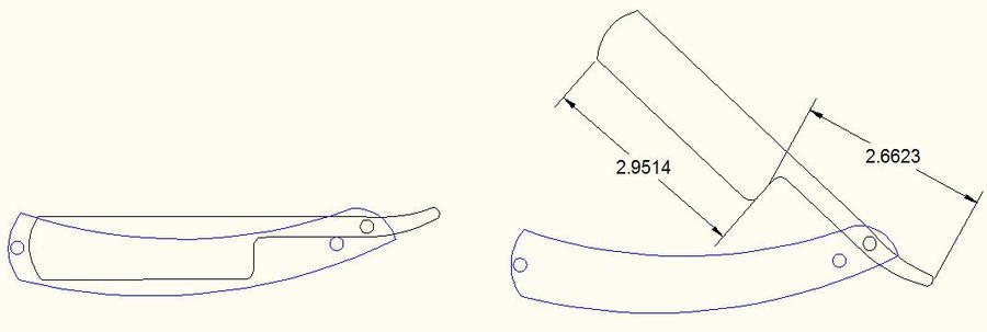

So iv been debating buying a straight razor for a while but with the prices they are i thought id go one step further and make my own.
So i did a little reading and fooling around on autocad and this is what i came up with im just curious if the people with experiance shaving this way think it would be functional.
and if my image thing dosent work heres the link http://woe-bringer.deviantart.com/#/d46zzs2
The steel is going to be S30V and the handle i havent decided yet.
so what do you guys think?
It all looks ok apart from the stop pin. Sometimes you need to be able to fold the handle right back out of the way to get access to the left side of your face with the razor pointing forward. Most straight razors don't have a stop pin for this reason.
ooooh alright ill remove the stop pin and ill move the butt pin in a way that will keep the blade from swinging to deep into the handle
Most of the handles have a swivel pin at the head and then no spacer in the butt pin, so the handle tapers. The hollow grind ensures that the blade is covered, but the thicker spine stops it swinging all the way through.
Furthermore, those models that utilize a stop pin simply have it set farther down the handle than the tail of the razor extends, thus allowing it to still catch the shank when closing, but not interfere with fully opening the razor.
The butt end of the razor DOES usually have a spacer, but it is a thin wedge which provides support for the material, and still causes the handle to significantly taper.
