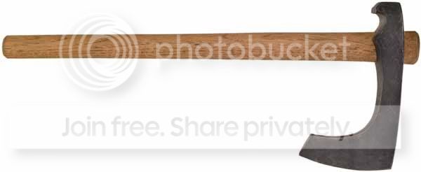

I like stuff with character, and when I saw this axe, I was in love. However, I am a broke 21 year old and can't afford alot of goodies. So would this axe do well in a outdoors/camping situation. Track of the wolf has it listed as a Woodworkers axe, So I assume it could hold up to chopping. But Im curious what you experienced outdoors folk think!
edit: Also if this helps at all, the head is 18oz and the edge is 4 1/4"
doesnt look like the head has enough weight for chopping.
i think a woodworker's axe is more for carving and the like.
and with that shape, the head would get stuck in the wood.
it would be great for shaping something, like making a lap joint for two logs, but i think it is not overall versatile.
The shape of the head would make it good for light chopping and taking branches off a fallen tree. But you`re missing alot of surface area there if you want to use your ax for splitting. It all comes down to what you want to use it for. Greatfor light chopping. Bad for heavy chopping and splitting.
These are not the answers I want to hear! Lol. I had that concern when I first saw it, but I though I would ask anyway. The look appealed to me so I fell in love. But like I said, I am a broke young fella and I need something I can depend on for chopping.Although I do have A Khukri, I want a tomahawk that can chop as well. Guess I will just go with one of the more popular all around tomahawks. Thanks!
Have one. Bearded axe. Works as well as any of the 23 different tomahawks I have. Better than my chair makers axe. Better than my NE belt axe, for all around work.
Outstanding as a carving axe. Throws well.
Looks OK to me.... you should check if the head is securely attached to the shaft, that's the critical thing.

The farther away from the work, the less control you'll have. The closer to the work type hatchet,even an El cheapo from the hardware store, would be better for chopping.
Buy an Estwing with the blue nylon handle. They make three sizes: a standard (small) hatchet, a big hatchet, and a light axe. Take your pick. Buy an Estwing now and it should last for your whole lifetime. You will love it!

If you want to split hardwood, most hawks are not optimal due to the drastic transition between the blade and cheek. The same is true of some models of GB's, which after all come from a land with little hardwood. Great cutters.
Because I carry a folding saw, my prejudice in an axe is for a good splitter. Don't need a cutter per se. What I can't (or won't) saw, I can burn in half.
