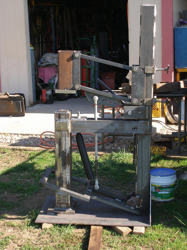

would something like this work for a powered hammer. The picture is pretty crude.
But the chisel tip would likely be cut and a hammer head or such metal would be welded in place. The leaf spring would be adjustable allowing the "hammer" to stay off the work piece till pulled down.
Alright let me know what you all think. If there are any questions. I'll try to answer.
Before this one gets asked. I dont have and probably wont have enough money for a Powered Hammer for a very long time.
Thanks for looking
Harbor Freight sells this exact setup as a sheet metal hammer. It's not going to do you much (if any) good to be honest. I can actually see it making many things slower and less efficient.
I'd suggest just getting a hammer and anvil, you'll get work done faster.

You might want to try something more like this. I'm told its a treadle hammer. Basically, its a foot powered hammer. I didn't make it. I just know how to contact the guy who did. I'm sure he'd be glad to help you with any instructions in building one.
nice looking treadle hammer!
the only other one I have seen had an overarm and the return spring was on top. (sorry, no pic) it also had swapable base plates and hammer faced so the guy could use it for dishing sheet stock.

What you are looking for is what's called an Oliver Hammer, basically a LARGE sledgehammer on a pivot, connected to a foot pedal.
But honestly, if you have limited steel and money, but you have time I suggest you just hand hammer.

In that case, I recomend a heavy piece of steel, like a section of rail road track, shape it to how you want, and some good hammers. That air hammer won't really do much. It lacks both control and power. Besides, there's nothing better than smacking hot steel on a bad day.:thumbup:
