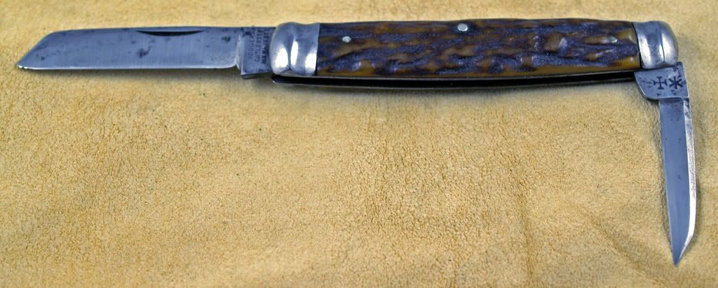

Well, actually, if the knife has real half stops, leaving the blades half open is no more stressful on the spring than fully open or fully closed -- the spring is in the same "neutral" position in all three blade positions. Now leaving the blades at 45 degrees or 135 degrees, that would be a bad thing, since that's the maximum stress on the spring from half stop blades. However, if the blades have cam end tangs, then leaving them at half open is bad - since that's the maximum spring stress point for that type of tang.......PS As reminder for all don't leave an expensive single spring knife with both blades open at half stop - save the spring.....300$s
