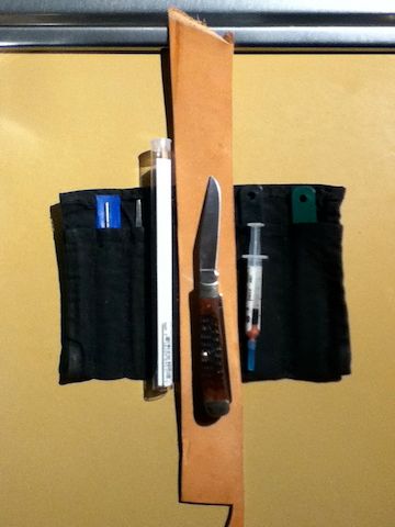

Here's the set up :
This will be a portable EDC strop. No backing just the leather strip.
Primarily it will be for S110V but will be used on softer stuff down to Case's SS (the Case Trapper shown will be the first thing I strop; it is toothy and in need of a bit of refinement to the brand new factory edge) unless you think that is a bad idea to "contaminate" the strop with steel other than the high vanadium carbide steels.
I want to try a finish side of the leather strop . . . most of my other strops have been hard maple with diamond or rough side leather with yellow or green "rouge" mostly, among others.

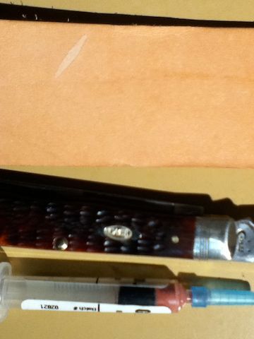

This photo shows the surface of the leather (smooth side) and how much paste I have to work with in the 600 grit.
I assume I should put all of this on the strop and order more. How is best to get all this out of the syringe ? It is so thick I need to dig it out with a wire; it won’t just press out with the plunger.
This shows my tool roll / portable sharpening kit I EDC to work etc. I would prefer the strop to be no longer than the Spyderco triangle rod and will probably cut the leather to be about the width of the black tool roll. In other words shorter than the Spyderco rod.
That should be long enough for four inch blades or smaller . . . right ?

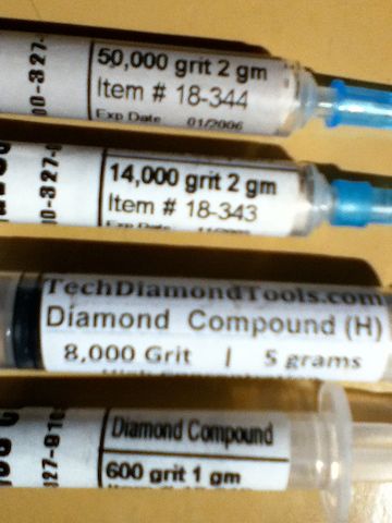

I have these other Diamond grits but am pretty sure the 600 is the best way to go for stropping my toothy. Do you agree ?

600 grit should be fine for what you are after, though all of the diamond compounds I own are listed in microns.
The amount you have left in your syringe would be a lifetime supply for me. For the length of leather you have pictured there I might put 12-16 small dots of paste and then rub it in. I'm talking very small dots... they would be about the size of the end of the syringe and maybe 1mm tall. You don't need to cover all of the leather because as you strop your blade will spread out the particles. Anything more than that tends to get wasted and scraped off the first couple of times you use it.
Basically, I make the dot pattern look like you find on Atoma plates or DMT non-continuous plates before spreading the compound out.

I would recommend a coarse stone followed by 1 micron/14,000 grit diamond paste. The toothy polished edge tends to work better.
I would also recommend using balsa wood for coarser compounds. Unlike the leather that will make a 600 grit compound work like a 800 grit or finer compound the balsa allows the compound to cut closer to 600. The leather would be best for getting the most polish out of the bevel. Because the leather will make the compound polish finer it works well to bring the luster up on a polished bevel.
