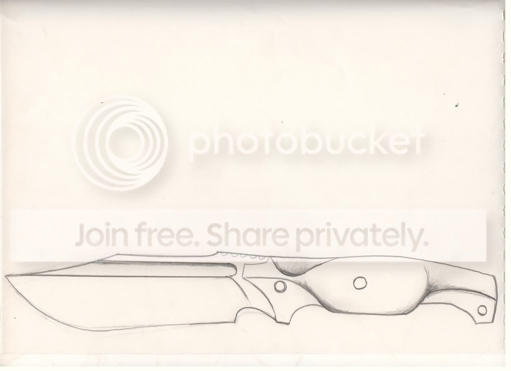

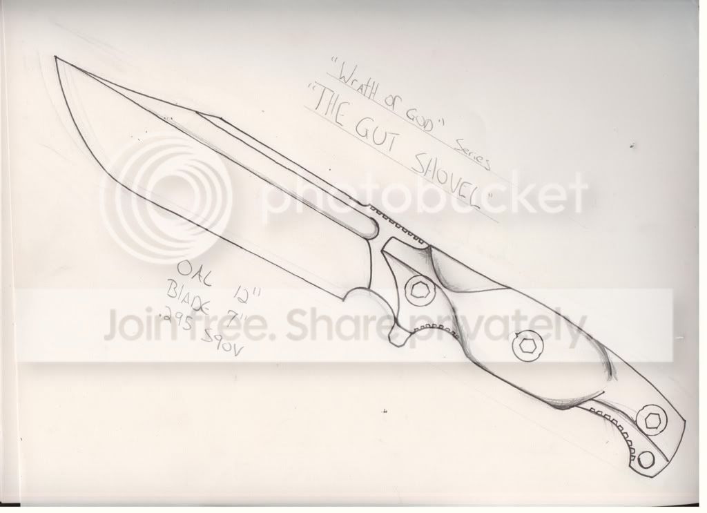

Peter calls this the "Gut Shovel"!*
It's a Medium Sized "Super" Fixed Blade made of .300 thick s90v!
Each offering will have a Modern Bowie with Blood Groove Theam. Except for the CQC Waki by Jake it will only have the Blood Groove. ;)
Also, handle material? Personally, I love canvas micarta but there are a lot of great options.

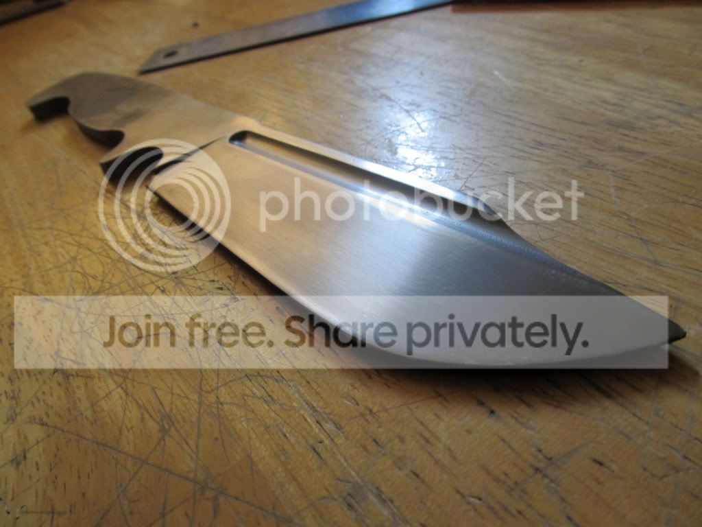

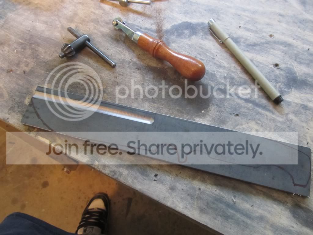

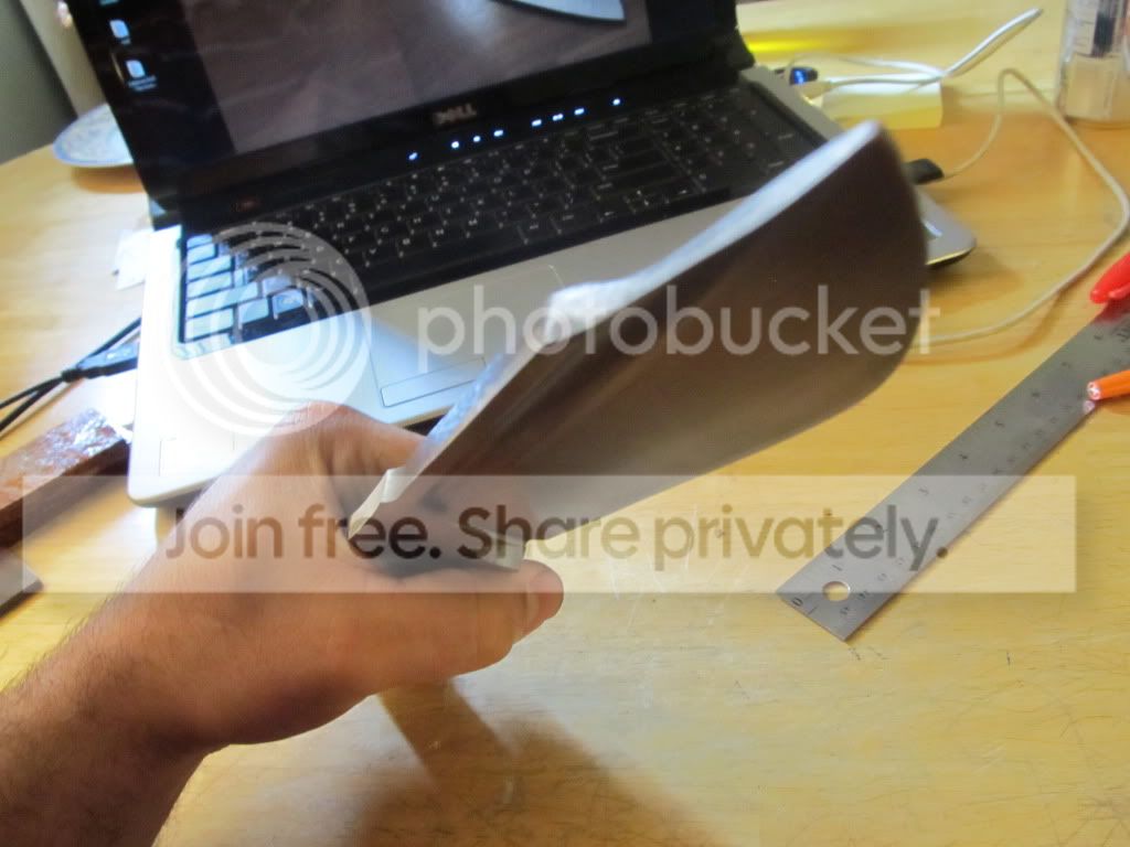

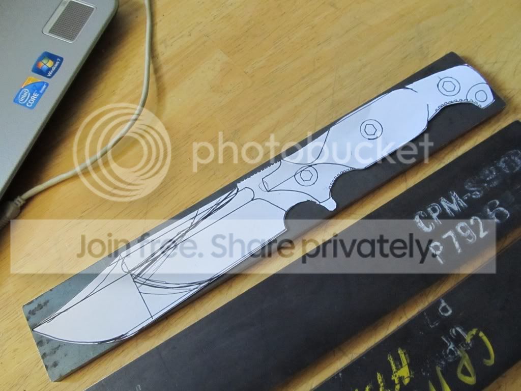

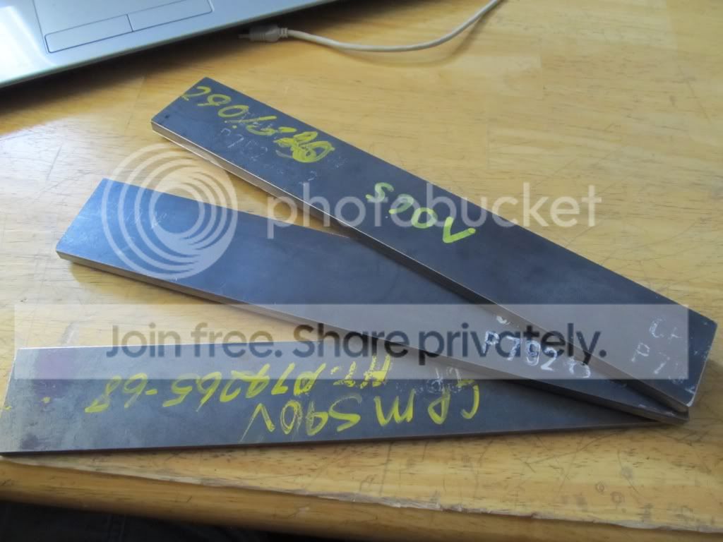

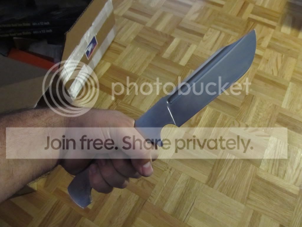

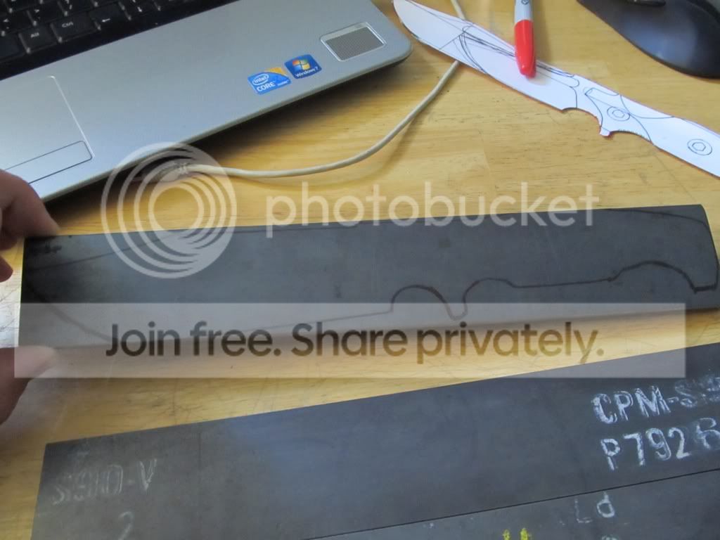

those are the preliminary wip pics!!!! i got the steel yesterday and started figuring things out.

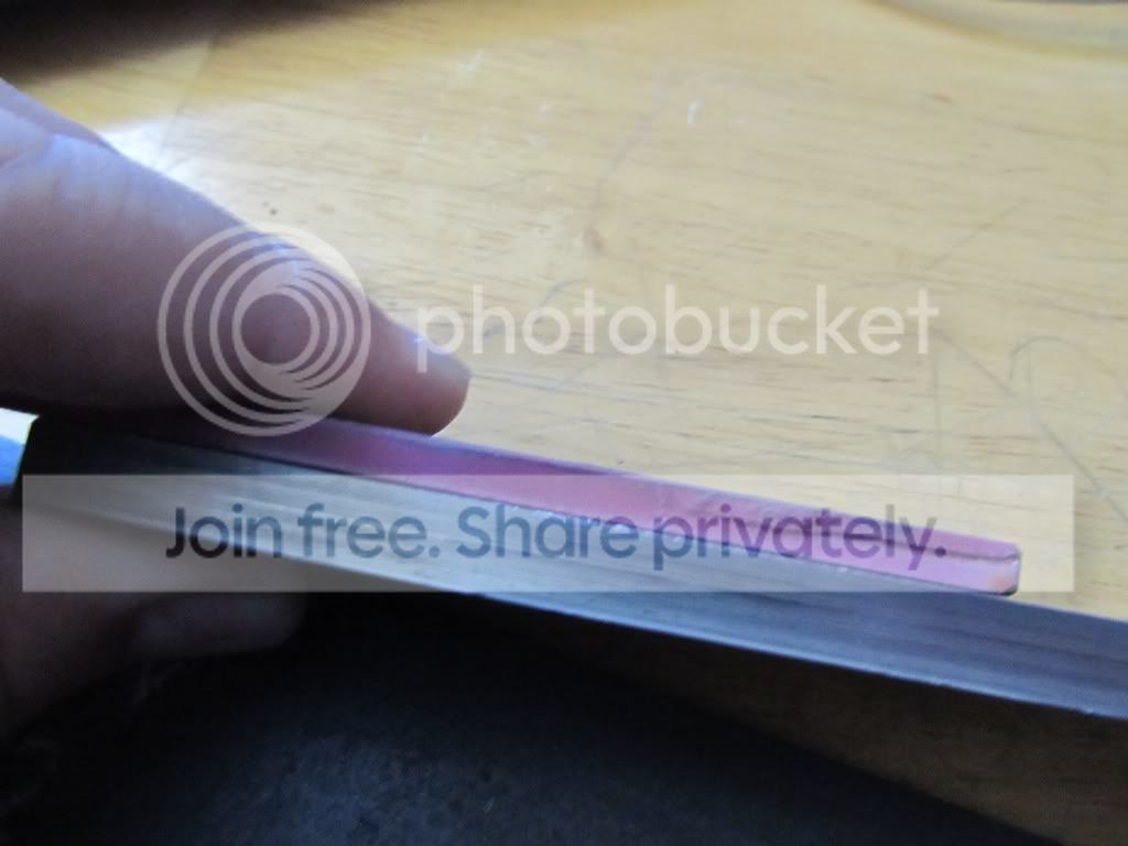

the steel is .30 inch s90v and it is thick!!! in the thickness pic its next to a piece of 3/16 ths stock.
the scales will be held on with titanium chainring bolts and not glued. the handle will be hollowed out for a balance point about half an inch behind the forward finger choil. this should allow for better chopping when held by the main grip area and better control when chocking up for detail cuts.handle relief area will be slightly oversized to allow for easy use with gloves.
