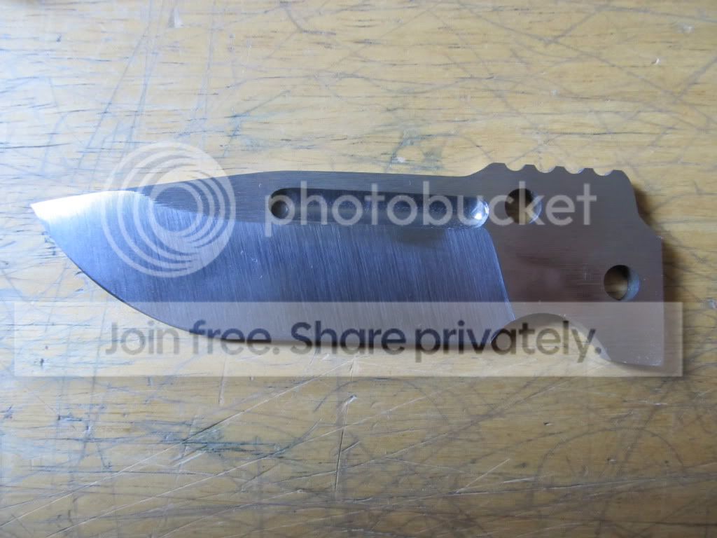

its a full ti frame 3/16 slabs. the back portion up to 1/2 inch from the pivot hole is recessed 3/32 inches. a g10 or cf overlay is added to fill in the 3/32 removed. this overlay acts as a stopper for travel of the lockbar...and looks sharp ;)

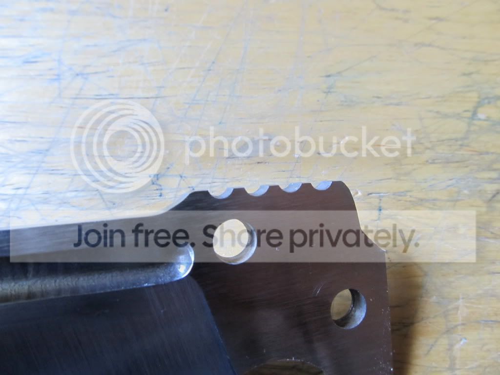

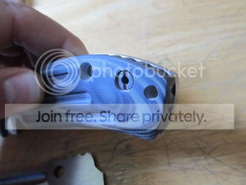

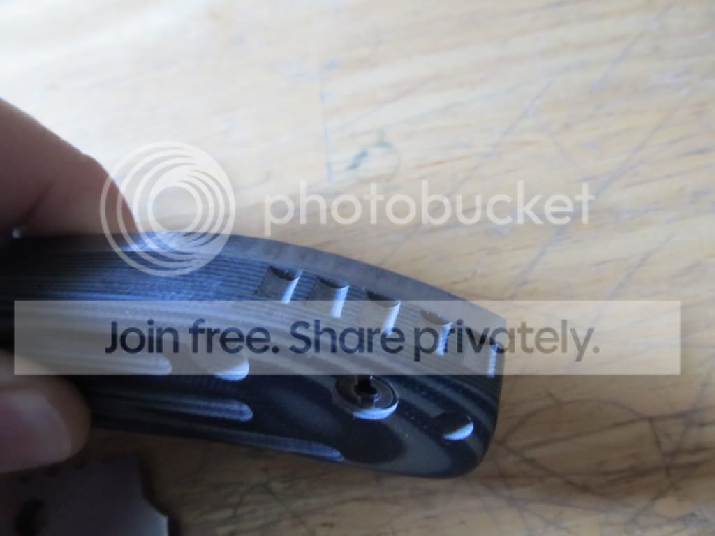

update photos! jimpin as requested by Chad
i have some supplies and am feeling good this week. well ove alog nicely i think!
