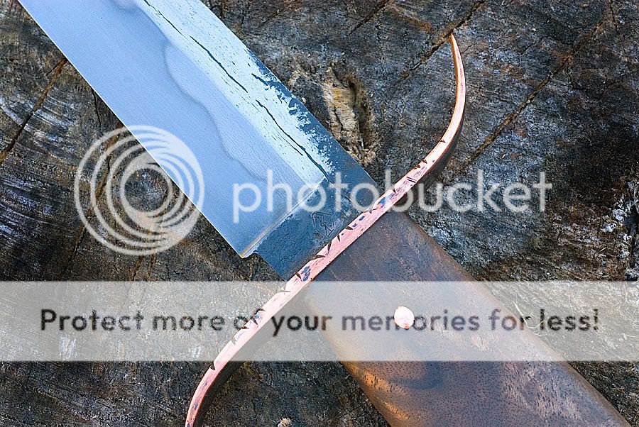

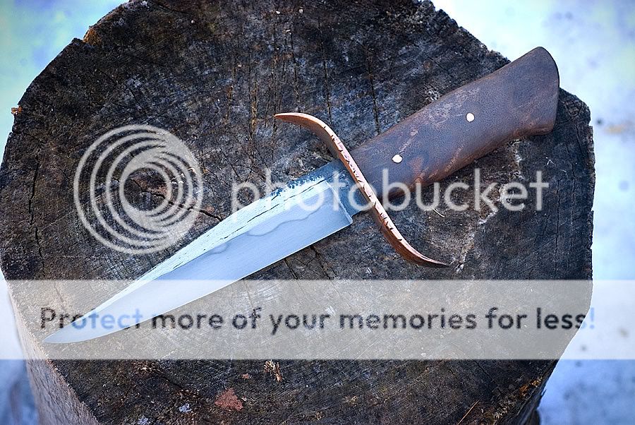

Here is an 8" blade bowie... Arkansas Toothpick?... with wrought iron/W2 butt-weld construction. Wagon wheel wrought iron was forge welded to the spine of the W2 and then drawn out length-wise. The blade was then clay quenched for a hamon. The natural patterning of the slaggy wrought was brought out with a long, slow etch in ferric chloride which also brought out the hamon. The copper s-guard features 'battle scar' filework. The wood is claro walnut with a morticed, hidden tang construction and the domed copper pins are riveted through the tang for a bomb-proof handle. The spine is 3/16" at the guard with a nice distal taper making for wicked, well balanced blade. The knife feels incredible in the hand....
