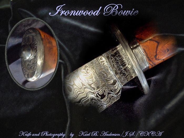

One ready for the mail man for a customer who has been a pure pleasure to work with.
(Gotta love it when they say, "Just do what you think is right." :thumbup:)
A 9 7/8" blade of laddered Ws of 1095 and 15N 20 - hot-blued.
Take-down fittings made from the same billet.

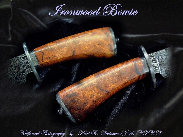

A really choice piece of Premium Desert Ironwood for the grip.

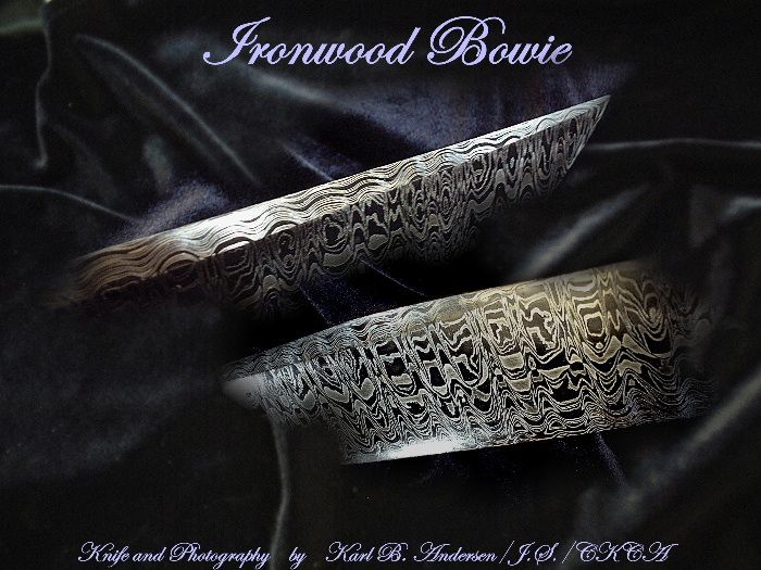

I tossed in that picture of the false edge because I just find nothing prettier than the false of a laddered Ws blade. Maybe it's just me.
Jeez Karl--your stuff just gets gorgeouser and gorgeouser. Nice bowie! :thumbup:
Holy Smokes! That's some bold damascus! Now I know why I was picking your brain the other day on this stuff. Your dang good at it...
Very, very nice work Karl :thumbup:
I love the finial nut details, and like you, I think that false edge pattern shot is beautiful !!

What method did you use for exposing the W Pattern on the Blade for this one ? Did you tile or accordion then ladder or was it just the act of laddering that exposed the pattern as shown ?
Reason I ask, I have a large W Pattern Billet I'm working on at the moment (my first) and I'm to that point.
I need to make a decision of how to procede in that regard.
David, I started with a 12 layer billet - 1/4"+ 1095 and multiple layers of 15N20.
Welded, drawn out and re-stacked to 36. Tripled it.
Drew out a ways, turned 90 degrees and crushed the Ws.
Drew that bar out, tripled it, re-stack and weld, drew out, and then either doubled or tripled that, cut and re-stack and weld.
Drew out to maybe 7/16", forged blade profile, layed out and cut in ladders.
Smashed 'er flat and called it a day.
