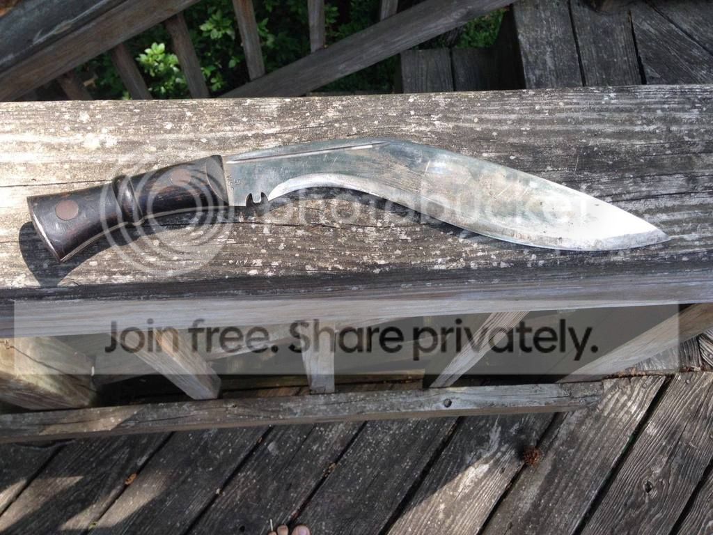

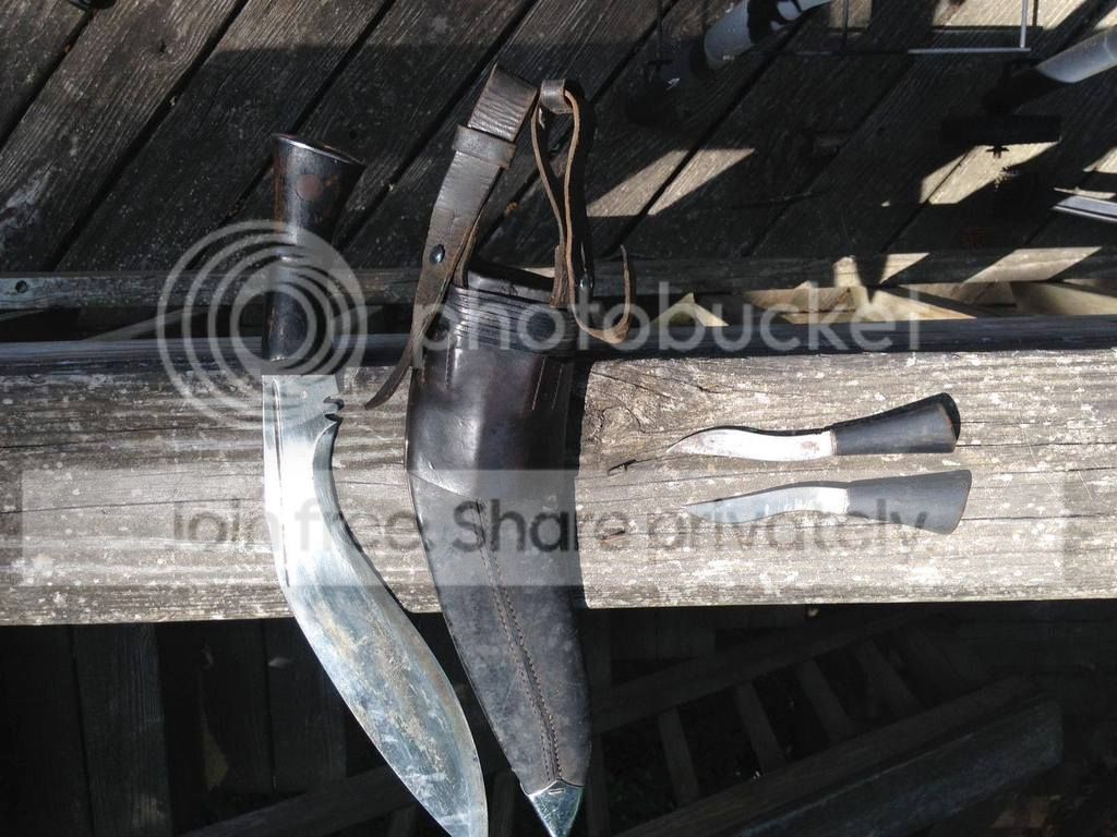

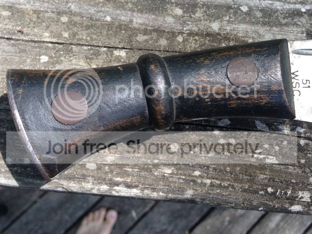

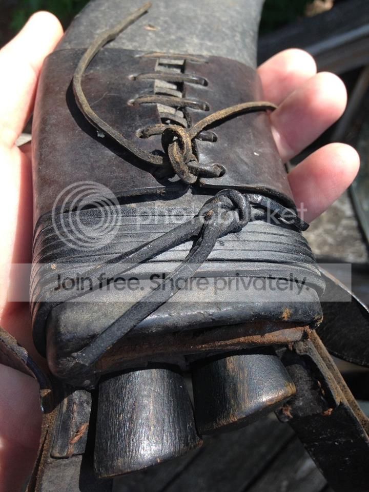

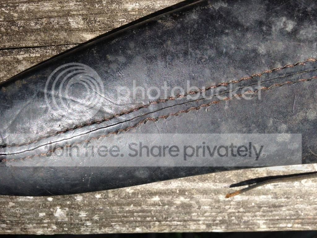

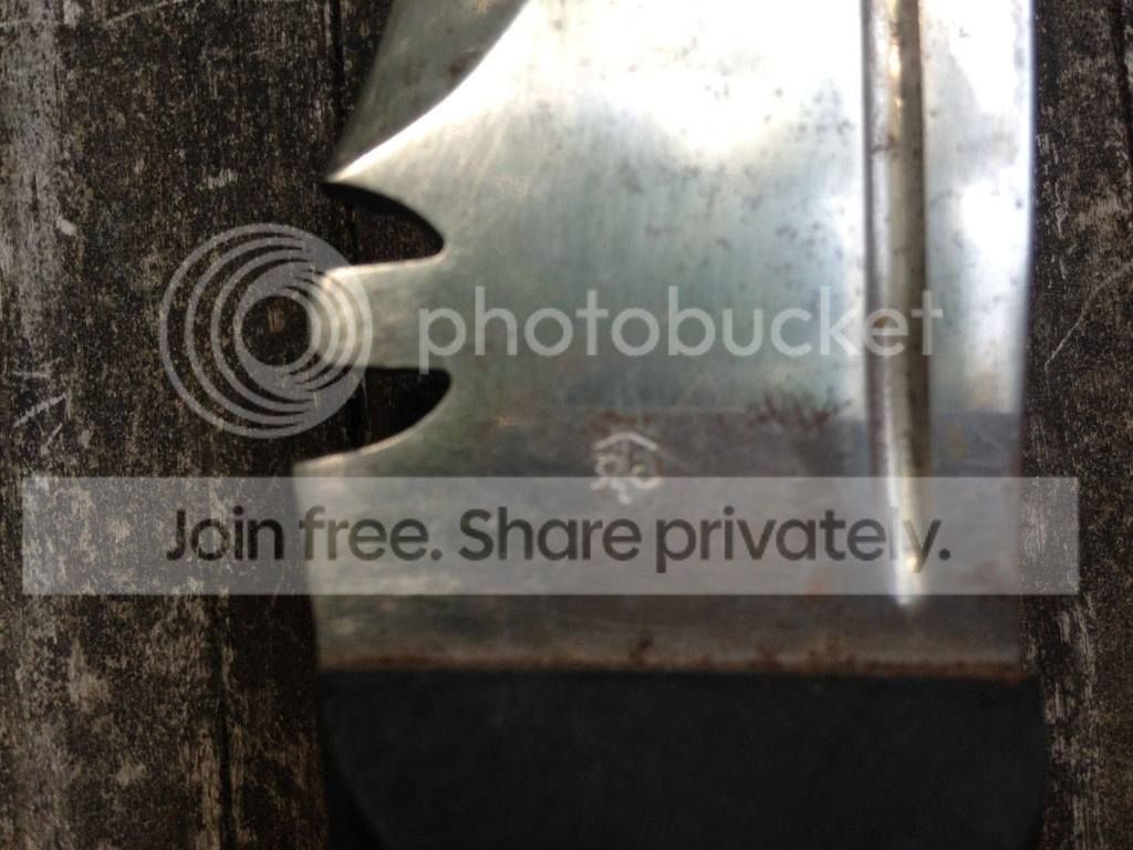

Christmas came early for me this year. As I am writing this reply, I think I have found the Holy Grail and it is on the way to me !!!! Here are some pics of the Wilkinson WSC51 that I have found.
[/URL][/IMG]
I will be keeping this Wilkinson WSC51 Kukri
I would very much appreciate if you can help me with the following questions:
1) Is the sheath and frog original to this kukri??
2) Should I keep it as it is?? Or have it clean and sharpen?? ( I will not be using it)
3) Is there a WSC51 registry to record who owns one of this kukri??
Thank you very much for all your posts on kukri. I have learn quite a lot from your posts.
Cheers.
Hi! Thanks for your pm at IKRHS, sorry you had trouble uploading pics there, the software is a bit outdated & none of us are IT guys.
To answer your question, yes frog & scabbard are correct original Wilkinson sword product.
Cleaning the blade with baby oil & 0000 wire wool would be good.
As a collectible best not to sharpen, if its a weapon & your going to war, or wish to use it tool, then sharpen it.
That may reduce its value somewhat to some future collectors of kukri though, if ever sold.
Its a good find, I only know of about 20 of these in various collections around the world. {One chaps got 7 of them!}
