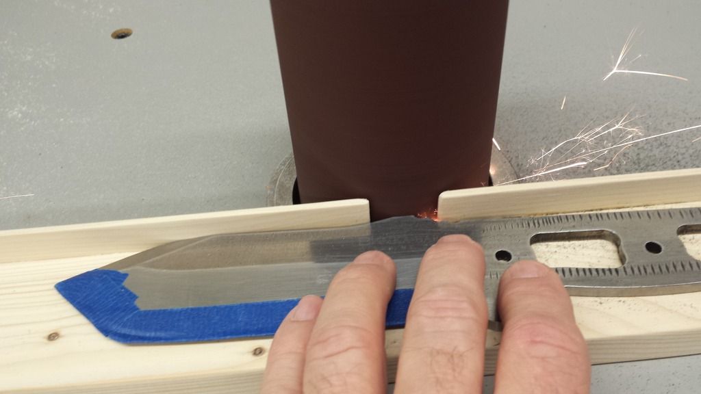

I've used a spindle sander and a disc sander to remove ramps.
I made a simple jig to prevent the removal of too much material. Using 220 grit, made a few passes then checked temp with finger. If too hot to touch, placed spine-side down on wet paper towels for 30~60 seconds. Takes about 10 minutes. When the jig wouldn't allow any more metal to be removed, I switched to using sandpaper taped down to a known flat surface and sanding spine-side down until the entire spine was flat.
Here's a BK10 being deramped on the spindle sander ...
