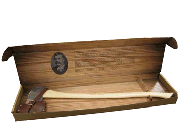

My axe arrived in the mail from Sweden today (via the UK)! I ended up going with a Hults Bruk forrest axe. Pretty much identical to the Gransfors Bruks. It's technically a Hultafors because they bought out HB but they're still made by HB in the HB factory. It comes with a nice leather slip and a hickory handle and came shaving sharp. I went with the Hults Bruk because my hatchet is an old HB. I'm sure I'll still buy custom at some stage. The handle length is 20” (50cm), and the weight of the head is 0.85Kg.
I had a bit of a chop in the backyard.
Nice great dane (and axe) I have a dane almost exactly like yours, same markings, but mine seems a bit smaller.
Nice axe Tim, Whilst I dont have any knowledge of how good HB,GB Council or Wetterlings are, I can say that I love the old stuff as the steels are damn good, Plumb, Hytest, Kelly, Keech/Aussie Speed etc....of which I have several of the above in my shed & box. I hope that axe is what you are looking for. It does look good, Collins is another old school make worth considering also, although Im sure theres more qualified on here than me to answer that....
