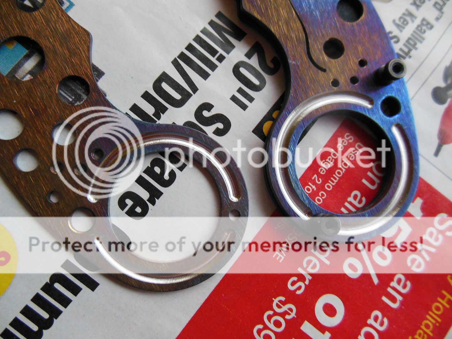

Inherent rough finished thin liners shown had an existing warp condition, once disassembled without associated support, along with thin blade stock....resulted mod was done on a mill without inducing any further distortion to the original warp condition:
I don't carry this knife...too flimsy to depend my life on it...being an unique case...did what I could...but serves well.... if looks could kill!!
One the other hand, this came with thin liners but true and flat. Already came with PB washers....but I made and increased .015" to the OD, which is maximum extent for all practical intended purpose + a few personal touch:

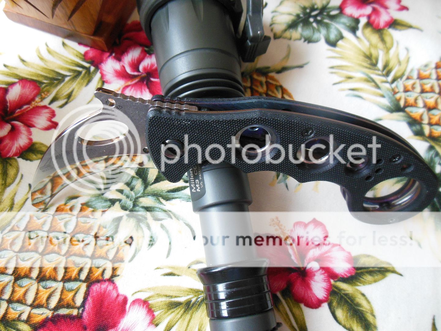

Note: This IS a 3-1/2" XM-18 that was originally a flipper model. I converted to non-flipper, and removed the jimping back of the stop pin originally because it was abrading my damaged index "flipping" finger. (I lost 1/2" of the tip when it got tangled in a motorcycle chain in an accident 45 years ago). The frame dip still works as a comfortable thumb rest now.... and oh,...yeah,.... the PB washer was inadvertently placed on the wrong side of the non-lock side liner for the photo.
