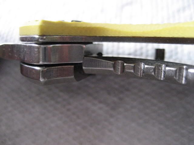

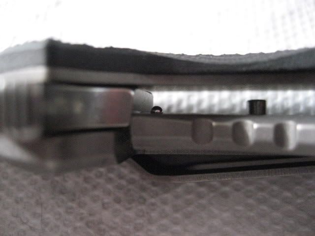

I recently scored a non-flipper XM-18 and a flipper XM-18. Both are 3 1/2".
The non-flipper is super smooth and almost auto like, its that buttery smooth. The detent looks normal and does not stick up alot. It definately serves its purpose and looks like alot of detents I have on other knives.......The flipper is not as smooth, more sebenza hydraulic like. If I just use the flipper, no matter how hard I press on it, it will only open half way as its that stiff-like. It will open with a wrist flick though. On the flipper, the detent sticks way up, about twice as much as the non-flipper and the blade catches on it. No matter how much I depress the lockbar, the detent since its sticking up so high catches on the blade tang. When you put a little more effore into it, the detent rolls up over the blade and does its job. Just doesnt "feel" right. My question is, does the detent on the flipper have a different height spec when compared to the non-flipper ??? Is this normal that it slightly catched on the blade tang ??? I tried some CRK lube and it helped very little. I took it apart and lubed it up, but there was not any difference when opening and closing as far as stiffness goes.

To me, it looks like the Detent is not seated deep enough.
Hopefully some of you guys that have had both or do have both can compare yours to mine and see if they are the same ???
I took some pics to help you better see the detents.
Yellow- Non Flipper -- Opens with perfection
Black - Flipper - Detent catches on the blade

Thanks for the heads up, I was adjusting it after I posted it and a little bit definately goes a long way like you said. I was turning in about 1/32"and trying to find a sweet spot. I was setting it to how my non-flipper is. I got it pretty well adjusted. But since the detent is sticking out furthur on my flipper, there is more blade tension.

I remember someone else in this forum who had exactly the same problem with the detentball sticking up very high. He also posted a picture of the detentball and it looked exactly like that. Don't remember if it was a flipper or non flipper though. I have 2 mx18 both non flipper. Generation 2 and 3. Both have normal detentballs but the lockbar on my 2 gen is very hard when closing the blade. It hurts my thumb when closing with one hand. But on my 3 gen it's much softer and I don't need much force releasing the lockbar with my thumb.
