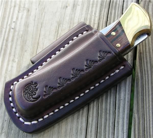

Excellent job on the sheath:thumbup: Gary...I've seen many of your sheaths on BF but can't remember one that had the stitching so close to the knife. Really looks good, trim and clean, is this a new style? Preston
Preston, here is one made, wow, 3 years ago? man time goes quickly!!
It belongs to Richard on the forums, and it's a photo he took as well
it's an anniversary edition 110 and he wanted a special sheath for it
the stitching is close to the knife, the area outside the stitching is a
little wider, that varys sometimes, this is horizontal style sheath, more
work involved, more layers of leather, there is a
Top section
a layer of leather beneath that
then another layer of leather the full length of the knife
which is then trimmed from the end of the sheath and folded
down to make the belt loop, so at the entrance area on the bottom
are 4 layers of leather there, makes for a solid sheath;
G2
Thanks for the reply, photos and the explanation, Gary, I think the wrap around aspect of your sheath gives it the simple, trim, compact look...I like it very much. Great work:thumbup:. Preston
