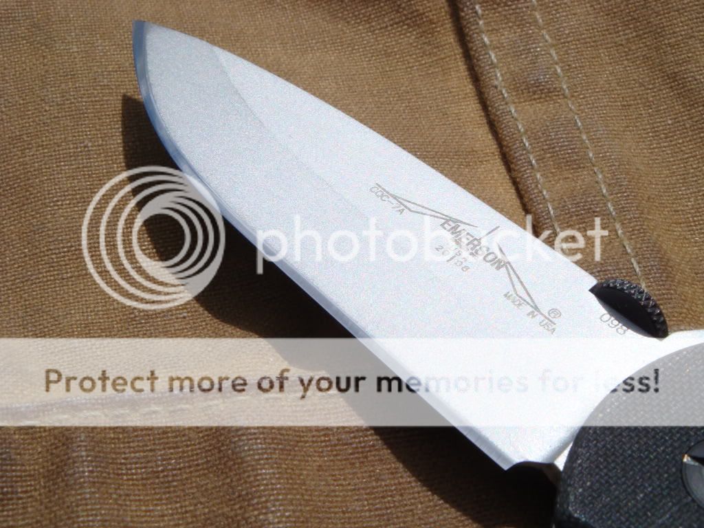

i dont know how many times folks complain about the way EKI's are ground & that because of the grind ya cant get 'em sharp, etc, etc.
last nite i decided to sharpen my production CQC12 for the 1st time, i only carry it for SD and rarely use it but it was after 2 yrs starting to need it, i used a norton india like i always do on EKI's but couldnt find my gerber steel which is what i usually do the burr with, so anyway i just used the cardboard on the back of a notepad (like ernie says to do) and 5 mins later my '12 was good to go and easily taking off hair on my arm, easily, if this one isnt sharp i honesly dont know what sharp is lol. in fact it got so sharp i am gonna hold off for a little bit on getting it kreined (yes i know it will be sharper after tom gets thru with it lycosa lol & i am gonna get it done just later vs sooner)
anyway, point being, i wonder sometimes WTF with the funky griinds myself lol but with the right tools, the right technique and a little time any EKI will get plenty sharp, if yours wont its more likely your problem not the knifes grind lol.
as far as a real CG like a tanto '7 my SOCFK tanto again is plenty plenty sharp, hair shaving sharp, all it takes is the right tools and technique.
oh and i also did my custom '13 the 1st time last nite, again plenty sharp, i was slicing long thin ribbons of newspaper easily with it & the hair on my arm is -0- problem.
so, they will get plenty sharp i promise ya.

I am new to this EKI thing though very pleased. I used my 7A enough in near a week I just had to tune up the edge. I use an Arkansas Hard Pink Translucent stone and I also strop. The knife is a freekin razor! I have a question though. I am a bit fuzzy regarding the edge or grind designation of these knives. My knife has what I would call a "Chisel Grind" but the description was "V Grind" so what do they call these? I am a fan of the Chisel grinds and they are very easy to maintain IMO. If someone can clue me in on that I would be appreciative. :)
Its a V grind with a single edge bevel. Some folks will say yay or nay either way but thats the best description I can give.
The actual chisel grinds are flat on the back side.

they are not a std "V" grind thats for sure, if i had a nickle for everyone who bought a commander expecting a std "v" grind and were disappointed i could buy a commander lol,
