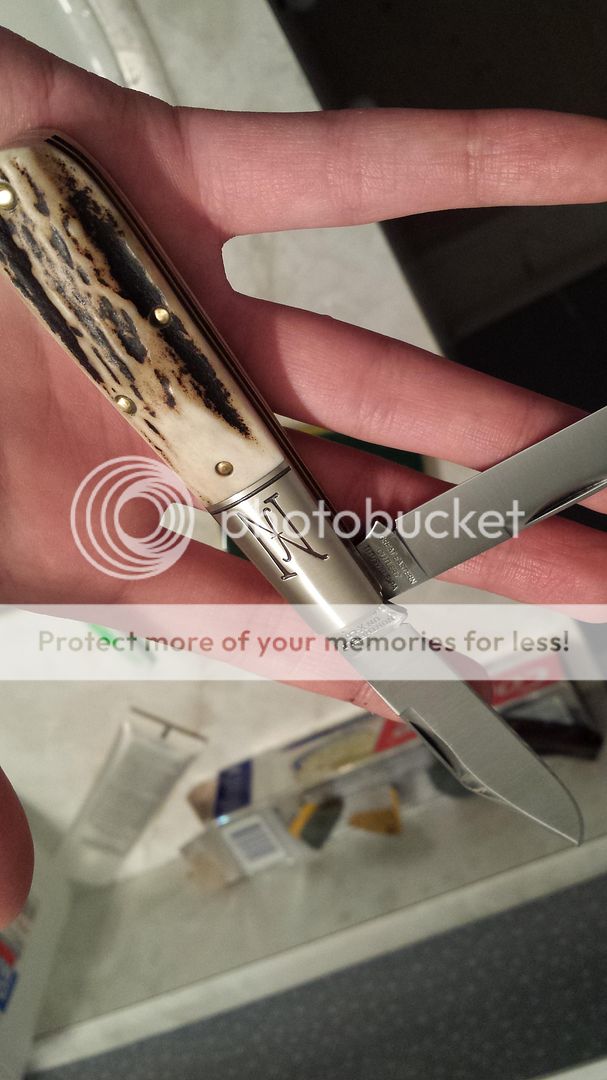

I use, carry, and sharpen all my knives and as such they get scratched easily. My biggest gripe with traditionals is bolsters getting all scratched up and looking very dirty. Given that the bolster material of many traditionals is nickle silver, they scratch extremely easily and what began as a polished bolster becomes hazy and messy. I took my stag #77 barlow and refinished the bolsters, the springs, and the scales. The bolsters were as described above and I gave them a brushed finish as the scales were far too polished for my liking. I refinished the stag with a green scotch brite and buffed with beeswax. It has a nice matte color and much "warmer" feel. All in all I like the knife much more, though some may find this cringe worthy. If the bolsters were steel, I would leave them alone as a nice aged patina would look nice, but I can't get the same with nickel silver. Here are some quick cell phone shots as it's in the evening with no good light available.

Thanks guys, in regards to what I used, I just wrapped a thick eraser in 600 grit silicon carbide sandpaper. Just use really consistent movements and the end product is pretty easy to get.

Yeah it still scratches but they blend in much more then polished. I probably need to sand to 320-400 grit for a more durable finish, but 600 is all I have at the moment. Also what do you mean by the nail ends showing?

I think Steve may be referring to the pivot pin that can become visible through the bolsters when polishing? Seem to happen to CASE knives a fair bit, less with GEC and interestingly, rarely with Queen. They may use a different bolster construction?

What Will said. I know on Case knives if you buff the bolsters, the pin will buff out faster because it is softer.
