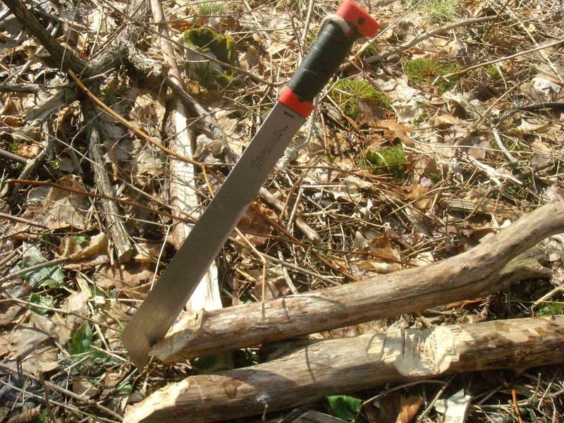

i chopped this branch with the machete:

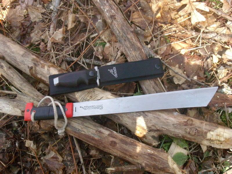

the machete with the gerber steadfast in sheath:

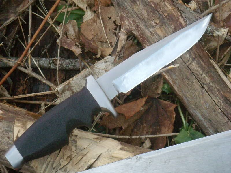

the gerber:

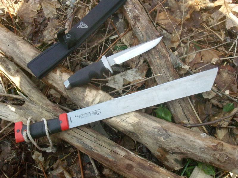

machete and gerber glamour pose:
the gerber:
