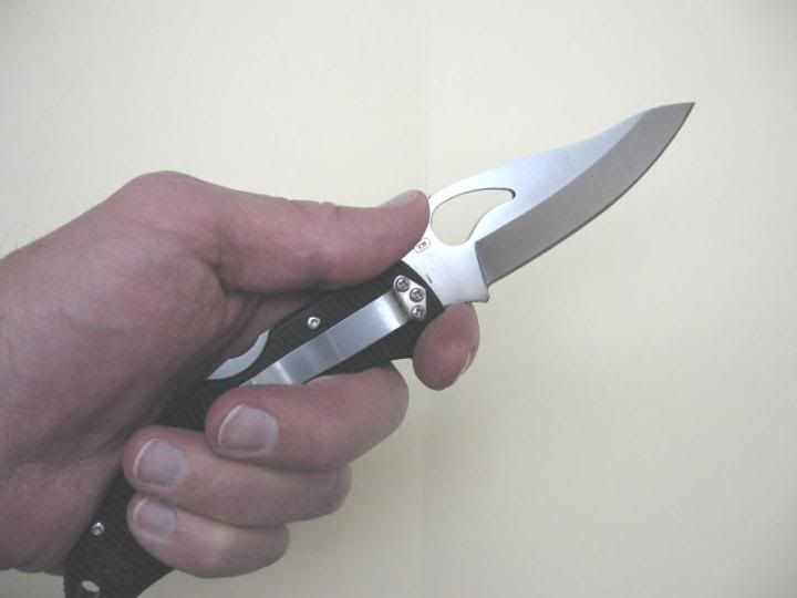

Ergonomics are generally quite good, especially with index finger in choil:
Jimping appears laser cut, but is comfortable and increases purchase significantly, only objectionably sharp on second ridge from top on thumbrest. Slightly rough texture of FRN seems to improve grip, molded handle pattern offers some grip improvement but only in certain directions. Comet hole works very well, generous size and nicely radiused to prevent thumb from slipping out while not being abrasive.

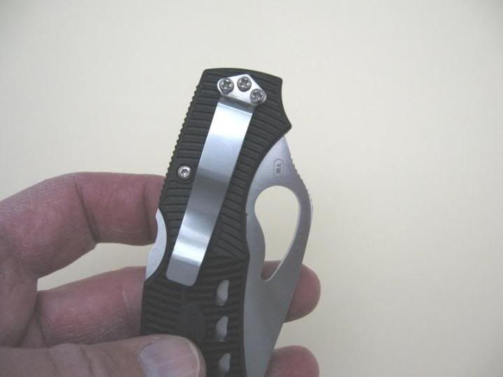

The unpainted pocket clip seems to be quite stout with no sharp edges, and when installed for tip down carry gives a low ride in the pocket:
Folded the Cara Cara presents a mostly smooth and pocketable profile .... no snagging gap between the handle and back of blade (like Spyderco's Paramilitary and D'Allara models for example) and only thumbrest jimping might look to cause wear on clothes or scratch other items in pocket.

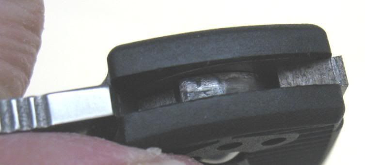

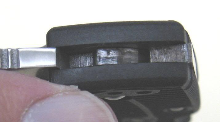

Although there are no problems with lock engagement or with the the knife's action in general, other than the weak lock spring already mentioned, machining and finish in the lock area is somewhat crude:

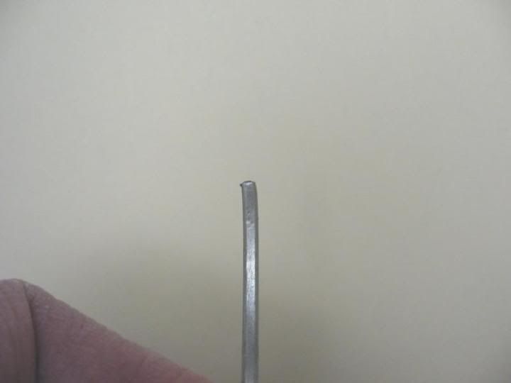

Lockbar spring removed, showing burr and slight L-R bend:
The spring is softer than what you expect with spring steel and can be easily filed. Elasticity is low as well, making rebending very (too) easy. During reassembly some of the additional arch added was lost, but a worthwhile improvement in lock tension was achieved. In fact the spring is a very odd piece, crudely cut and bent and made from rough semi-square, semi-round stock, about .01" wide and thick; hard to believe this is a standard engineered production piece.
FWIW the spring doesn't seem to be the only problem here, lockbar length and geometry are contributing factors ... as it is the spring contacts the lockbar too close to the fulcrum point. However a new lock spring of quality spring steel, with more elasticity and slightly shorter than the factory spring, could solve the problem.

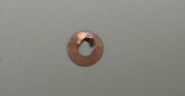

Disassembly also found the center hole in one of the bronze washers used at the blade pivot to be damaged and installed off center:
A couple light taps with a small hammer flattened the washer out much better than I thought it would, functions smoothly.
