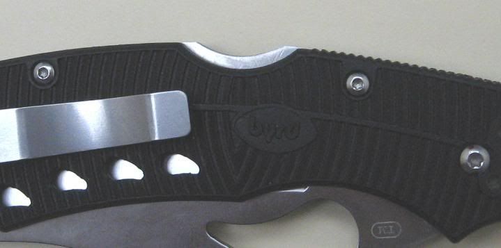

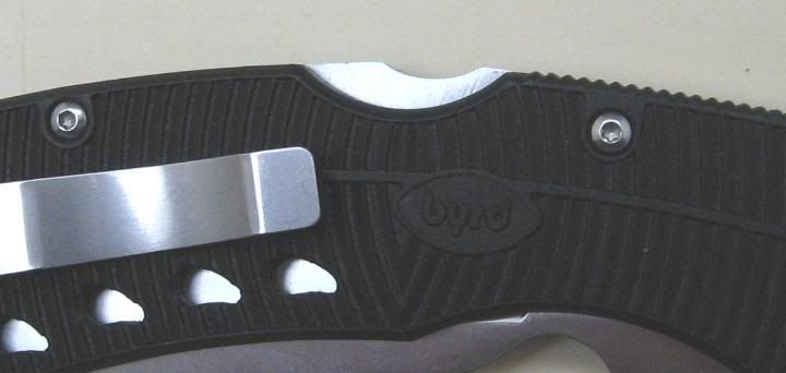

This reminded me I wanted to deepen the Boye dent. Before and after photos:
This is a good mod and for me much more comfortable to open using the inside of the thumb knuckle joint like I do. Thanks to the finger choil design this is an easy and safe lockback to close one-handed, BTW.
