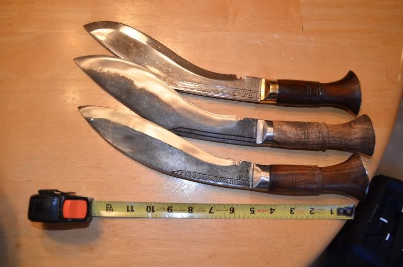

It's tough to say which is harder - picking which thread to put these comments in or picking which of the knives below to bring on the next camping trip :D
Top to bottom: BAS, KLVUK, UVK

Excellent review. You mentioned how lively yours was. I bought two KLVUKs and observed some differences in balance. One of the knives I received is a:
10 5/8 in blade (27 cm) kukri with a 4 1/2 in (11.5 cm) handle it weighs 18.60 oz (528 grams).
the other is:
10 3/4 in blade (27.3 cm) kukri with a 4 5/8 in (11.8 cm) handle it weighs 17.25 oz (488 grams).
What I noticed is the lighter but slightly larger in dimensions Kukri was sooooo well balance is felt even lighter than it's 17.25 oz (488 gram) weight. Both are nice and will do some serious work but it is interesting to see major differences in small things such as 1.35 ounces.
Your review also got me thinking of the reason the Ugly Villager (KLVUK) looks the way it does. I think it looks this way because it is a working man's/woman's knife. It traditionally is for farmers and field workers. These guys/gals did not care about bling or style. They had the Kami make a tool that worked in whatever job needed to be done. So I'm kind of against refining or Blingalinging the KLVUK.
Sure Nepalis have nicer Kukris but that's just it. This Kukri is for farm work, this Kukri is for the house, this ones for ceremonies and so on.
Nice side by side bric. This batch of KLVUK have longer than average wooden handles. The horn handles are around 4 1/2 inches long.
It would be telling to have their weights for comparison. Weight is an important consideration for most hikers/campers because everything is carried on the back. So the choice I would make normally would be the lighter of the three.
