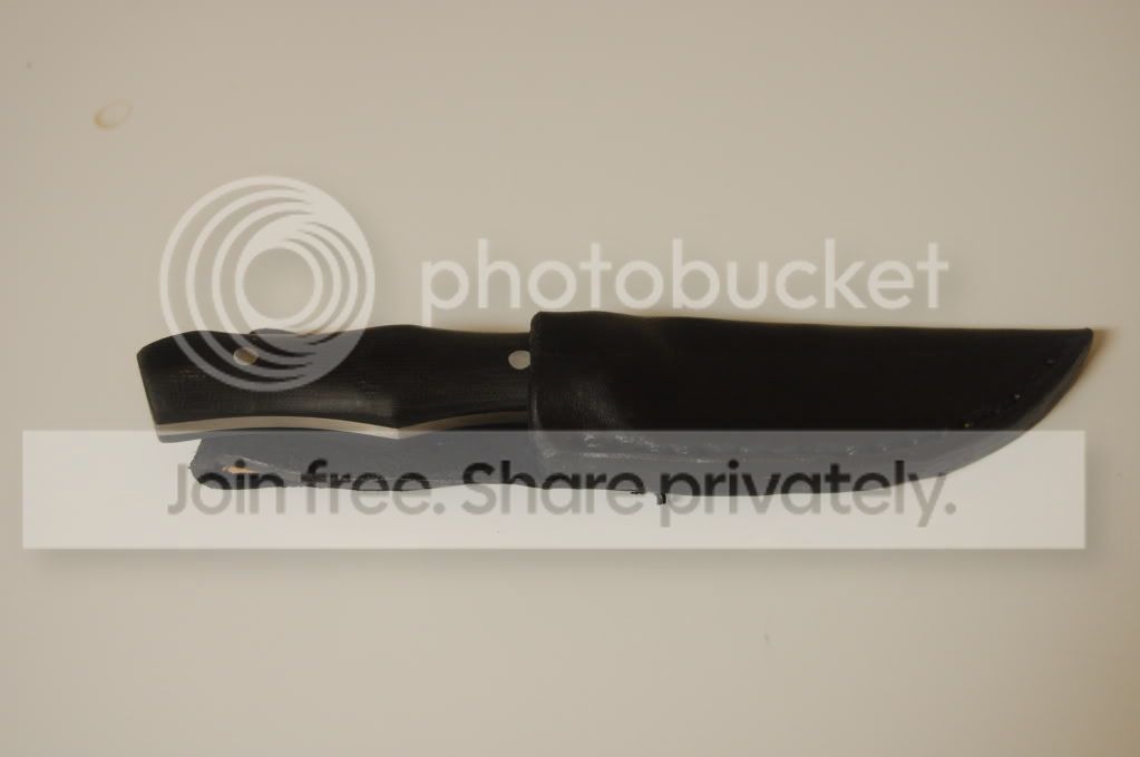

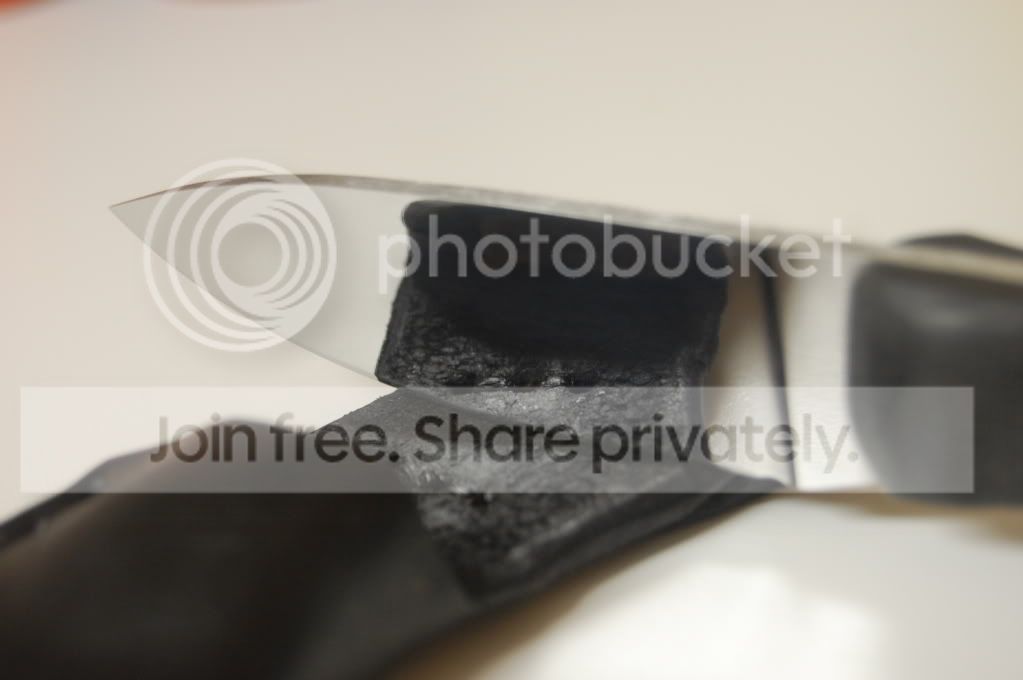

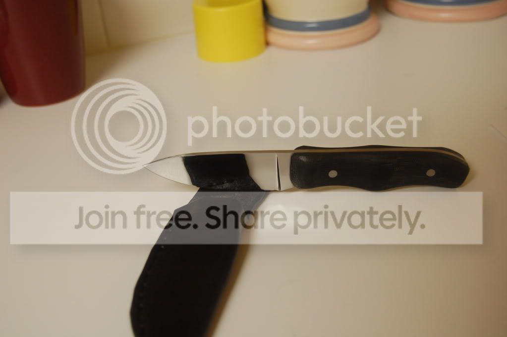

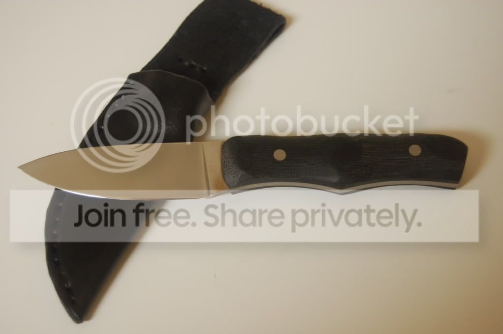

So, with that, I ask YOU... what would YOU pay for a knife like this, and pardon the pics:
It's O-1, proper (15 minute soak) heat treat in a digitally controlled reducing atmosphere oven, 0.020" behind the edge, 3" blade, linen micarta handle, stainless pins, stock removal, hand stiched leather sheath.
I guess I'll go first. I think that, for me, this would be in the $80 ish range. I am not usually attracted to the type of angular shaping to the handle, and the sheath looks a bit rough. I am not a fan of small sharpening choils, but yours is very minor so would be overlooked. The finish looks great, and you have a nice straightforward working design. Not to say that I do better, but as a customer this is what sticks out when thinking of purchasing it.
I was thinking kinda around the same lines. you fit and finish looks good, the sheath i think could be refined. i was going to say a bit over 100 with how it is now.

All that said, when I looked at your knife I thought, "Three-piece knife, good finish, kind of rough handle, $85." That's a nice knife. When Bill said 'double your prices, halve your customers and work' I think he had a point.

1: it needs to be worth what you're charging. A small well made knife of that construction might be worth up to $150 - but everything had better be spot on.
2: you can't just "try raising your prices" very well. You kind of just have to do it - not "try" it. The reason being if people see your prices going up, that can actually improve the value of things they bought from you in the past. A good thing. But if you go too high and sales go down and you want to lower your prices - people who bought at the higher price will see the value of their purchases go down. It is not good to see a maker's wares going down in value. This is a concern even for obscure user makers.
My suggestion is - if you're in the $100 range, go to $125. If you're already in the $125 range you need to figure out how to do things faster and make more sales volume. If sales drop too much once you've gone up - figure out a way to improve sales without dropping your price. Good photo's go a long way as do good descriptions for the educated buyers out there.
Obviously, never ever skimp on quality - crappy knives can be had at Walmart for $40...
Increase your prices as stated, but, I would also get a few sets of quality stabilized scales. Have a higher end knife as well as your nice users. Raise your price with those first. Then follow with the micarta. You have a great mirror finish and high end scales will help get you paid for it. On your sheath, just a bit more cleanup will help. One stamp and a border of that stamp adds a lot to a sheath. After I get mine stitched I use a sander belt to smooth the edges up then a belt turned inside out will burnish the edges. Finish your stitching by running the needles inside or coming out between the layers and cutting the thread off so no ends are exposed.

Thanks, guys.
That knife/sheath combo has been selling for $65. I agree my leatherwork needs refinement... it has been pretty negelected lately.
I really appreciate the input.
Taylor
I'm pretty new at this too and seem to have the opposite problem as you (more knives than sales), but I'd guess that knife with that finish and sheath could go between $85-110, depending on where you sell it and to whom. I'm for pricing a little more than I think I can get, because I know I won't get it if I don't ask. That's some good work you do, and $65 is too little for it.
One thought on saving cost is on a small utility like that do you need a mirror finish?You could save time/labor and equipment/supply cost by doing a satin finish.
Ditto...
You should be getting more money for a mirror polish. I would think $85 would be a nice price on that knife. With a better sheath maybe even $100.
At $65 I don't think you're getting your money's worth out of that mirror polish.
Also, does your market require a mirror polish? I like a nice satin finish. I won't worry as much about what the knife will look like after I sharpen it the first time.
I guess I don't have to do the mirror finish, but it doesn't take much time. I do a lot of finish grinding with 400grit Tizact belts, so when it comes time to polish I just hit the buffer and get the mirror finish faster than I can hand sand a satin finsih. Heck, on any knives where a satin finish is requested I go all the way to mirror polish and go back with 600grit paper.
I'll work on the handle and sheath quality. I guess I've just gotten so caught up in the blades that I've neglected the rest. I'll admit it... I loathe handle and sheath making, but "a blade does not a knife make". It has to be the whole package, and I understand that.
