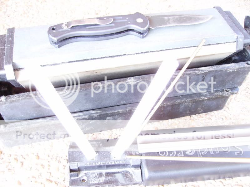

For most beveled edges, I use the standard brown and fine Sharpmaker rods, usually followed by stropping on newspaper. I want to pick up the UF rods before too long.

An 11" tri-benckstone and an M-204 to mantain.

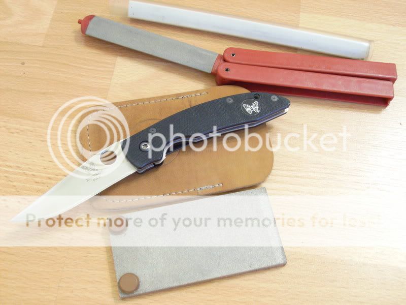

i've got a smith's diamond combination sharpener but i'd really like to be able to get my knife wicked sharp

I use a DMT xx coarse to bring it to a 12-15 deg. zero edge, then convex 400-2000 grit, then put a slight microbevel with a ultrafine ceramic.
