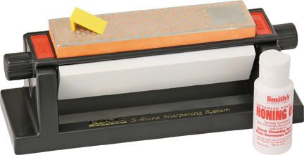

I've been feeling pretty disadvantaged because I can't seem to use a stone to sharpen any knife. As it is, give me a dull knife and a stone and I'll give you back a ruined knife everytime. :o
I've been checking these out and I just noticed the little yellow dodah sitting on it. It looks to be a guide to help hold the knife at the proper angle. Is that what it is and is it effective? I think I would like to give it a try and see if I can develop the skills needed and not ruin too many knives in the process.
go buy a cheap steak knife that not serrated and practice practice practice. or you can go get yourself a guided system from lansky or smiths and spyderco. it took me the longest time to learn with a stone. and there isn't any good way of teaching someone, you just need to go read/watch some instructional videos or maybe watch someone around you.

Yeah Dave,that yellow thing goes under you're blade to set the proper angle. A consistent angle on both sides is the most important thing when you're sharpening.I'm using the Smiths stones that look like the one in you're photo.Hopefully David Martin will weigh in on the subject,I believe he really knows his stuff when it comes to getting a blade razor sharp.

That little device may work, but it will hold all knives at the same angle, and not all knives are sharpened to the same angle.

That yellow thing doesn't work for me, as I like to keep the blade at a lower angle when pushing. The trick is to try to get the feel for the blade edge's angle and use the blade edge itself as your guide. Start out with knives that are slightly dull to touch up, gradually going to duller blades as you get the feel for it.
That tri-stone is a good set up. Start out with a relatively easy steel to sharpen (420HC) before you go to a premium steel. And yes, use Buck knives to learn. You, Plum, aren't going to use knives with crappy steel from China, or even good steels from other manufacturers. Get a feel for the steels you will actually use.

Thanks for all the input guys. I'm going to order one of those (in the picture) and start practicing. I already have the Spyderco Sharpmaker and the diamond sticks for it are coming, so maybe I'll have it covered.
