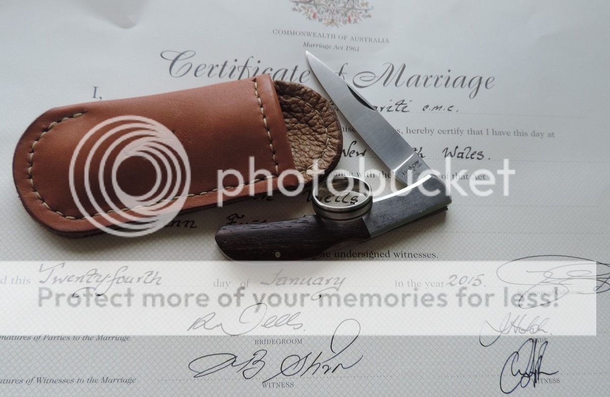

I make a few different styles - only for my own personal use ... group pic and also a pic of the knife & pouch I carried on Australia Day Weekend this year when I married my lovely wife. (second time round for both of us)
WB they aren't all that difficult to make - give it a go PM me if you would like a template
PS I do use Kangaroo leather occasionally ... on a weight to strength ratio its very strong
Brumby (from downunder:D)

Are you using a belt loop on the back of the pouches you have made or do some have a metal clip ?
I may buy a five dollar cell phone pouch just to get the belt clip and rivet it to my knife pouch . . . that is if I would get off my bum and make a pouch.
Congratulations on the marriage (remarriage ?).
PS: your style pouch is just exactly what I had in mind (but black).

That way of fastening the knife back to the belt loop .... simple but very effective. I'll give that a go myself. Actually I could easily retro-fit one to any of my existing pouches.
