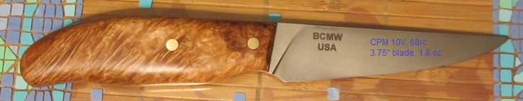

What would happen to a thin edge of CPM 10V 68rc incidentally hits bone, rock, hammer and nail?
CPM 10V, 0.076" thick, 1" wide, 4" blade, 8.25" OAL, FG
CWF HT 68rc
Sharpened 15dps with ~0.005" behind edge thick
Fancy Halloween Handle
Thanks for watching & comments

I only made one 10v halloween knife, so yes, I winced one or twice on the first 2 hits. But hey, need to break/damage to know the limits, then kick the limits a little further down road.
No point destruction test this slicer/boning knife. So, I fixed it up + a burl handle = double class fighter weighted in at 1.8 oz (48 grams).

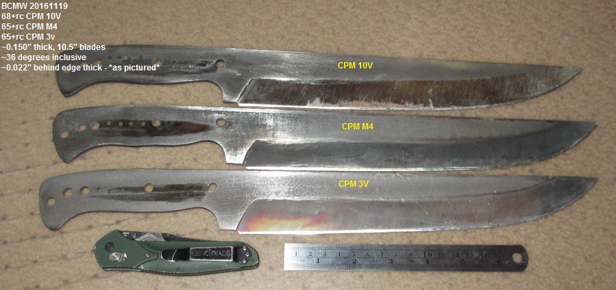

I need to make a heavier weight class to test impact toughness - 10V .156" thick x 1.7" wide, 10.5" blade, 16" OAL. Target hardness be around 66-68rc, 0.02" BET, 18dps. Test circuit: 2x4, 0.5 & .75" dia oak dowels. Oak dowel is murderous when chopping cross grain. If passed, it will face outdoor dried solid dead assorted woods. If passed, will hack up a partial rack of raw beef back rib. Um... probably won't get this far w/o macro chips (height >= 2mm) :nonchalance:
At the very least when facing a high possibility of wasting a good chunk of 10V... I want, this chopper to chop through a 2x4 with avg less than 12 hits and w/o any visible damage.
Any updates?
Oh my aching arm - 30+ minutes per chopper: 2x4, 1" dia oak dowel, 3" dia pine branch. Thus far, it took on avg 14 chops per 2x4 (hold by one arm, chop with the other).
Over shot 10V hrc a tiny bit but didn't see any visible edge damages except a couple fractures from erroneous apexed with 120 SiC stone for this 10V.

From what being chops - M4 is slightly heavier than 10V & 3V, so it chops through stuff best. Today, I gave the 10V another 20 minutes of hard chops oak board & dowel. Edge did fine.

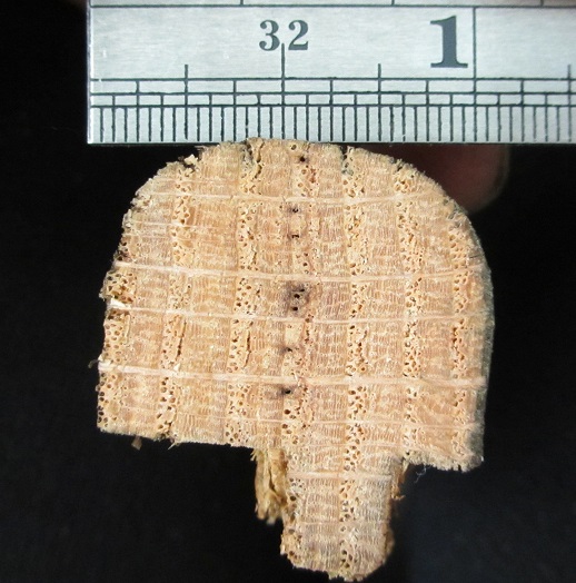

I gave up, can't cross grain chop through 1" dia oak dowel! Wedging dead-stop the edge after about 0.6" deep.
