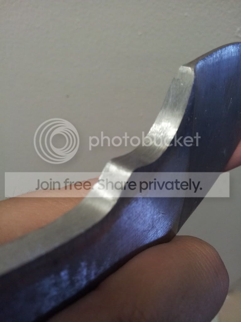

hey guys i just got into knofe making and i would like to know what u guys use for the tight areas, now i dont have a drum sander thingy wich is what i would gues u guys use, all i have is a 1x30 and patience. i bought a dremel 4000 today hoping it will be proper for that job. .my knife looks not so bad i jist need to get in the tight curved areas like finger choils and grooves but i cant with the sander. . is the dremel i bought good for that? good at all? ..thanks in advanced guys and ill have some pics later on when im done.thanks.
[/IMG]
I used half round files to rough out rounded areas and then used sandpaper around round dowels to finish my knives for a long time. Then I bought a drill press and got different sanding mandrels so I could use sanding drums. I think the ones I use most are 1/2" and 3/4". I do plan on buying a oscillating drum sander one of these days!
You can buy sanding drums and sleeves (in various grits) pretty reasonably. For example these:
http://www.woodcraft.com/family/2000276/2000276.aspx
You can mount those in a drill press, lock the quill and have at it, or even use them in portable drill run slowly.
You could even wrap sandpaper around a piece of tubing/dowel/pipe/roll of quarters and use that. Sometimes simple, age-old, solutions work the best. Learning to do things by hand, slowly, meticulously, before you go at them with power lets you see what's really happening as you work. The hand sanding that the pros in here perform on the way to their spectacular finishes are a testament to that. They spend hours at it for a reason. They also treat sandpaper as if it was free....................
A small investment in some Gesswein EDM stones at some point will open your eyes too.
Keep sening pics and don't be afraid to ask questions. EVER!. You'll be surprised with the help available here on BF.

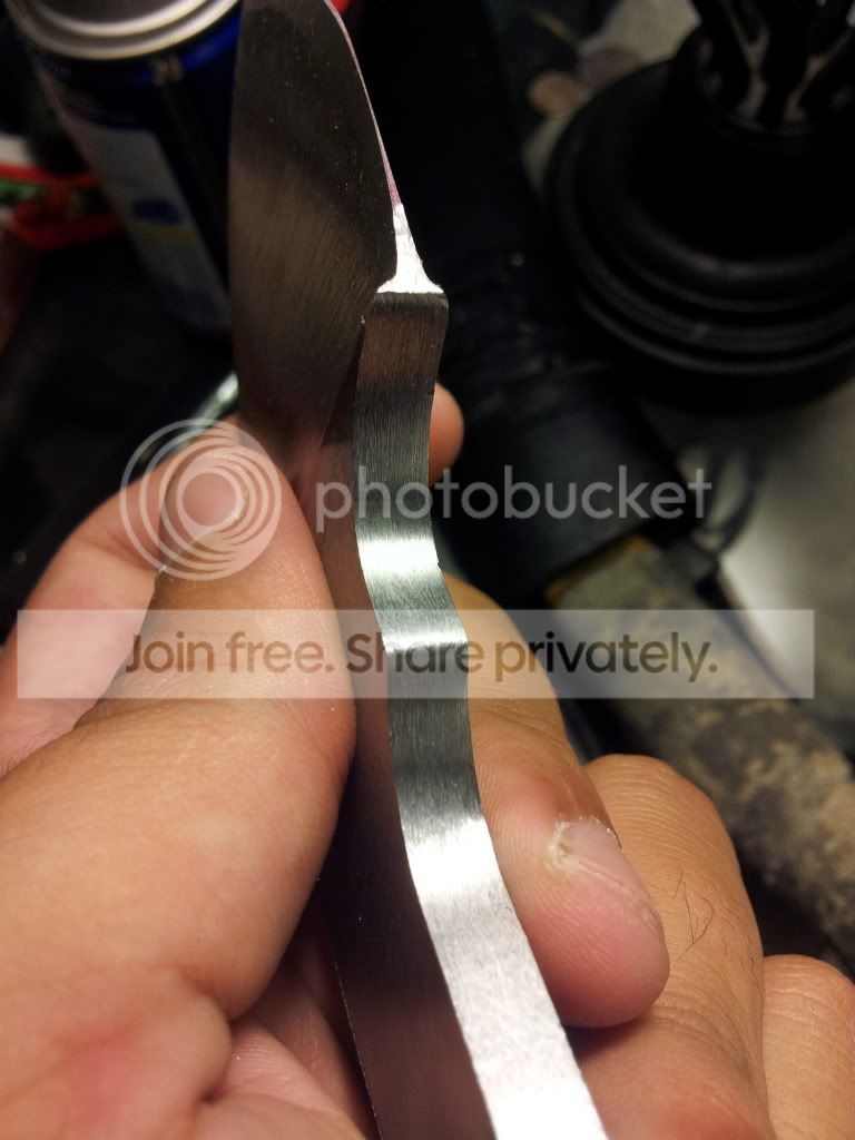

hey guys thanks for all the replies i really appreciate it. .i dove at it with the dremel and i think it came out ok, what do u guys think?. .i will defenetly look into the sanding drums/barrels but i need a drill press first as i dont have one at the moment (got layed of work) but i will get one if/when i sell couple knives i really want one. . but yea thanks again guys and the dremel worked ok i think.
[/IMG]
All the above is very good advice and I agree with it. the Dremel will be very useful though. I have one and also an imitatiom Foredom from HF. I use them all the time. IMHO you made a sound investment with the Dremel, but will still be doing a bit of hand sanding also.
