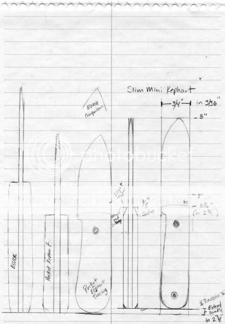

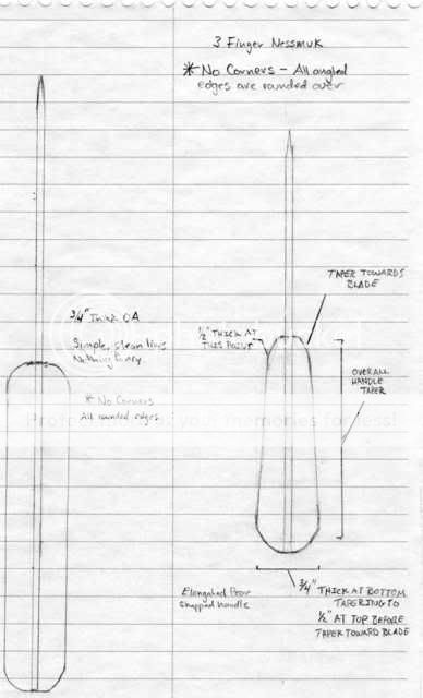

Here are my sketches of the baby kephart

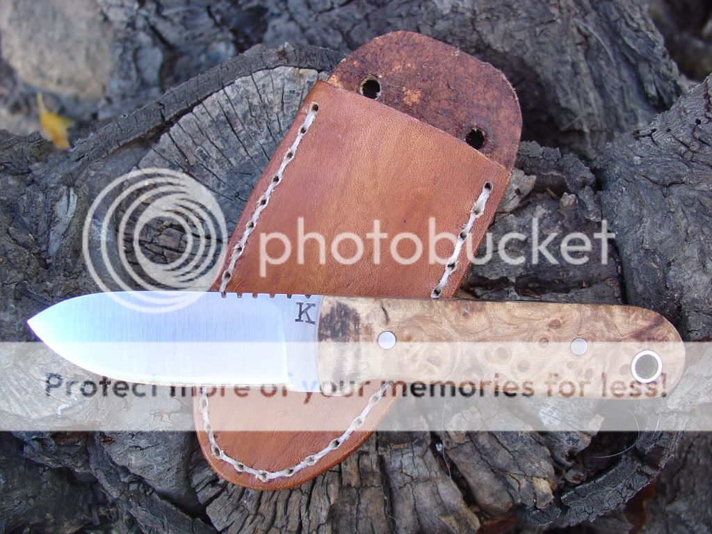

Here is the knife

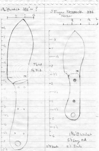

The mini nessmuk sketch (on the right)

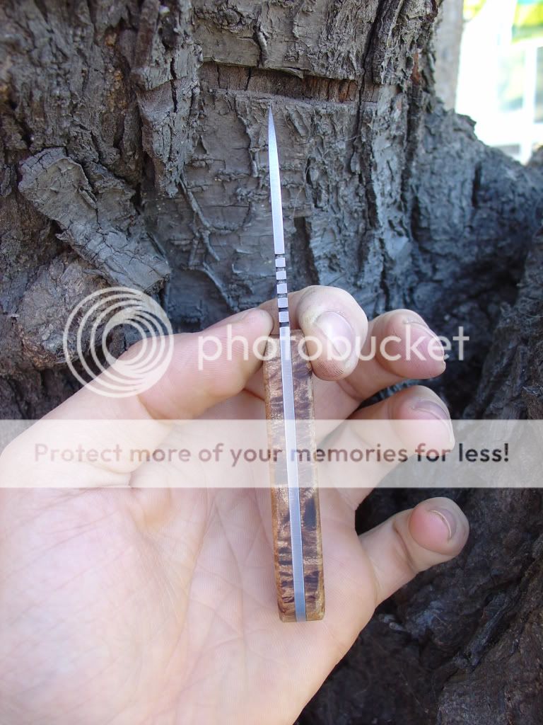

Here is the knife
Why are the fronts of the scales uneven?
In any case, John did a fine job matching your design. You also did a fine job showing what you wanted. If every customer could provide drawings of that quality, that would be fantastic.

Totally my screwup. :o When I drilled the holes I did not notice the plate of the drill press had slightly tilted. I had made the handle out of a tiny scrap of the wood I had left, then cut it down the middle. After the glue had set I noticed it, too late. I could have replaced them with a different wood, but he had his mind made on the maple. I did give him a discount on the price.
I love those scales! John is right, I REALLY wanted that maple, and it does not make a bit of different to me:D
The baby Kephart is nice but the mini Nessmuk is simply awesome !!!
The little nessmuk is incredible. The proportions are just right.
Great choice on handle material, as well.
