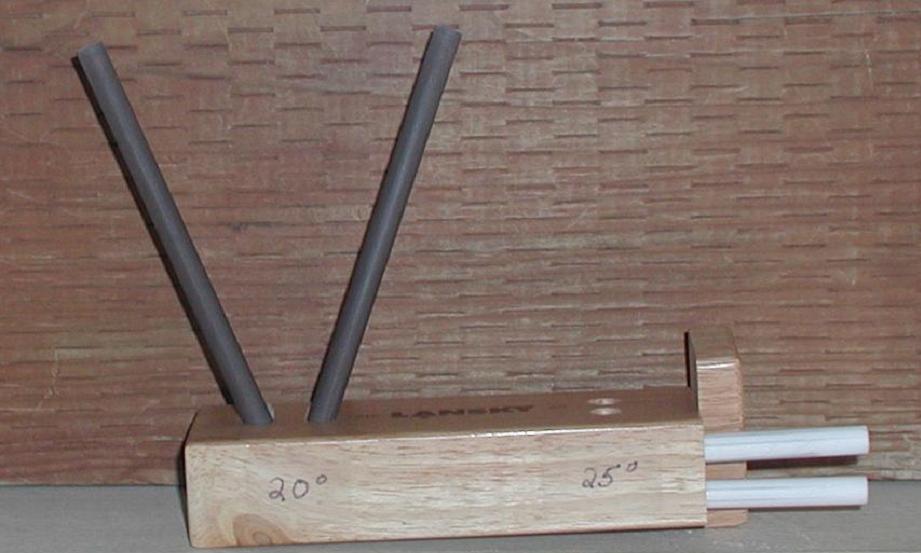

The OP asked about "Field Sharpening" and anymore I carry a Lansky 4-rod Turn Box sharpener with me when out and about.
They are small and fit into a back pocket or small belt pouch. You can sharpen almost any steel on the planet with these rods. When using a rod be careful that you don't swipe the point off the rod or else you'll round the point of your knife blade. Instead, just stop the stroke with the tip of the blade on the rod.

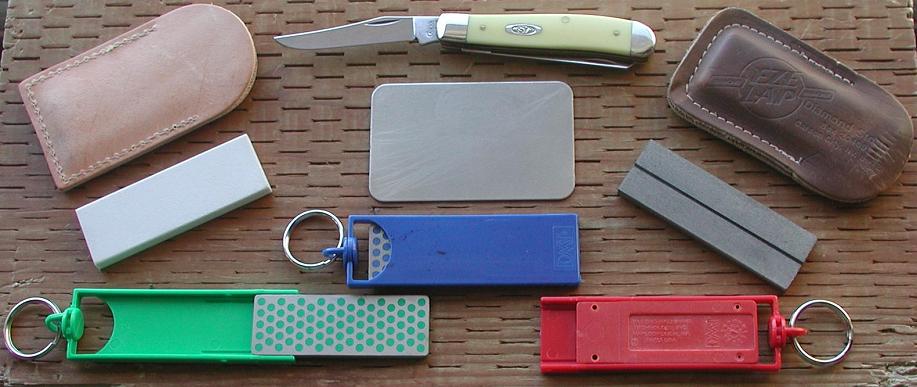

Anyone of these pocket sharpeners work well in the field - right dow from a small pocket knife to a rather large fixed blade.
