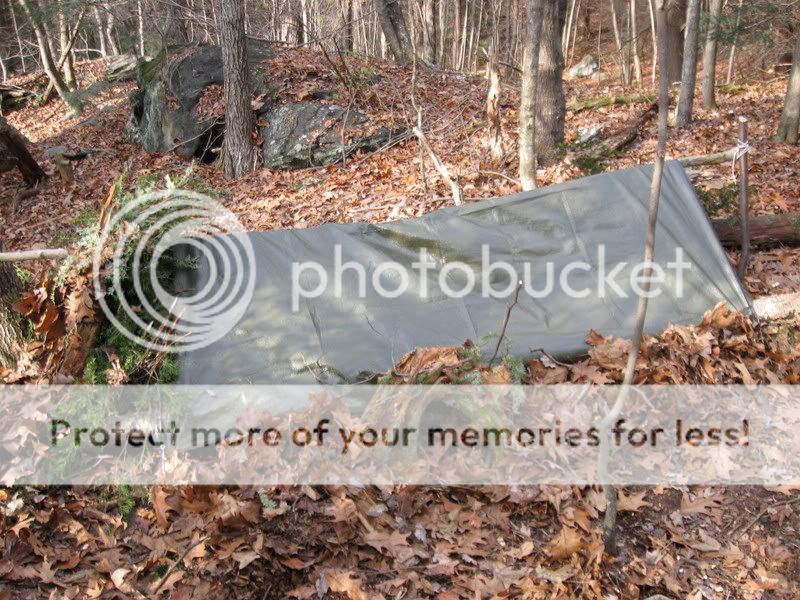

I set this up to give plenty of leeway in responses. I'll post a few examples...
This rock shelter involved finding the location, clearing the ground, finding and cutting a pole, rigging the poncho, removing some rocks, and collecting bedding. It took about 1.5 hours to get it to the point he could spend two nights here.

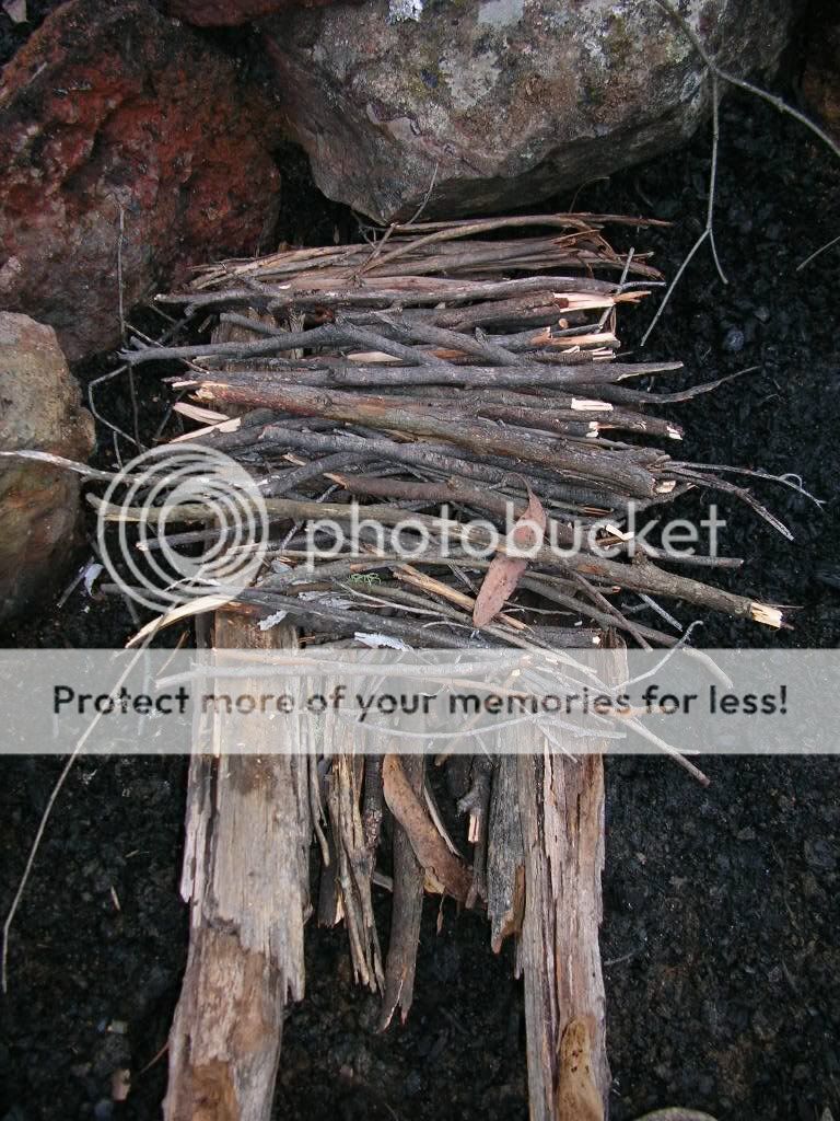

For a small fire, this pile gave me sufficient needs for my last campfire. I had an axe, but not a good sized saw which prolonged the processing time. A full sized buck saw would make the processing job 20 minutes, but with just an axe and in some cases using a knife to baton rounds, it was about 45 minutes to process. Give another 20 minutes to gathering the wood - in this case it was easy to find.

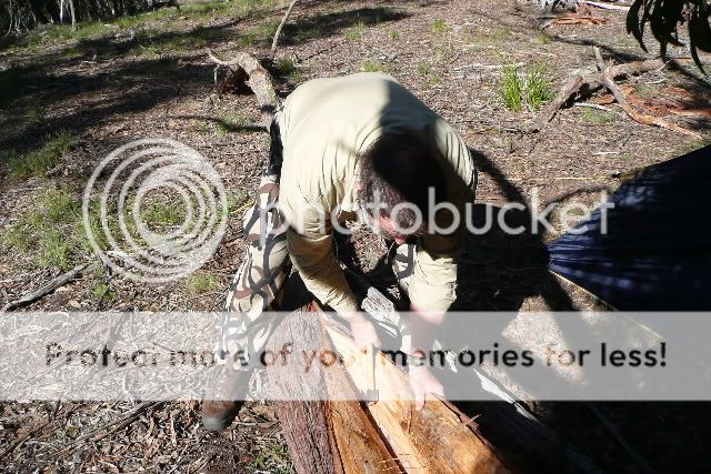

A couple of trips ago, a change in wind direction saw the need for a wind break at the end of the fly.
Using a thin green branch..
... and a Gb hatchet, I collected the bark needed from a fallen limb
All up (including stripping the bark ) the wind break took less than an hour and gave 5 nights of comfort.

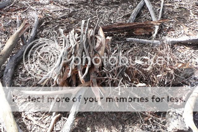

First up I always gather a fair bit of kindling of different grades before I light the fire. The kindling pictured took around 20 minutes to collect.
and use this as the basis of the firelay :thumbup:
