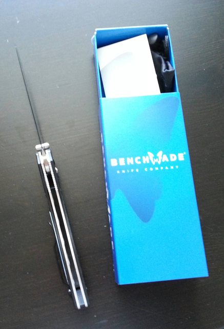

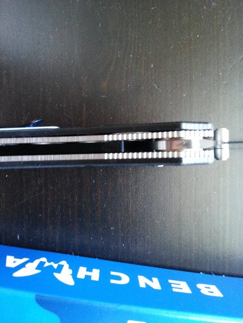

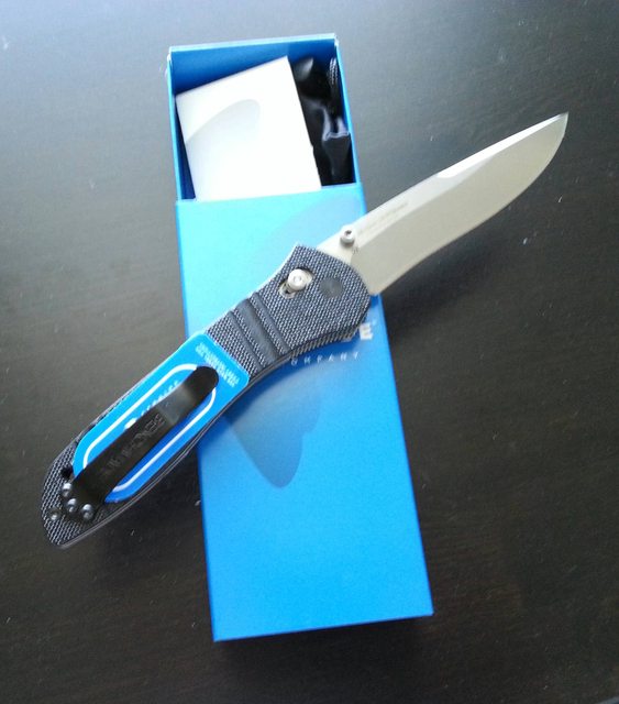

Couple of days back i went over to a local dealer here, thinking of picking up something new...after looking at a number of knives i had in mind, decided to get a second 710D2...what can i say...just like the 710 that much ;) it was almost closing time for them, so i did not really spend too much time inspecting the knife...blade seemed close enough to centered, grind looked good...but then when i got home and took a closer look...it seemed like the omega spring was stuck under the scale...
Here are some cell phone pics:
Went back and the dealer exchanged it, no problems. However, they only had three come in and this was one of them. Another one had the blade way off center, almost touching the edge, and the third one, which i ended up taking, has an uneven grind near the tip of the blade...
I know these are production blades, but i had higher expectations of BM quality control...
The 710D2 that i had purchased earlier was pretty much perfect...
