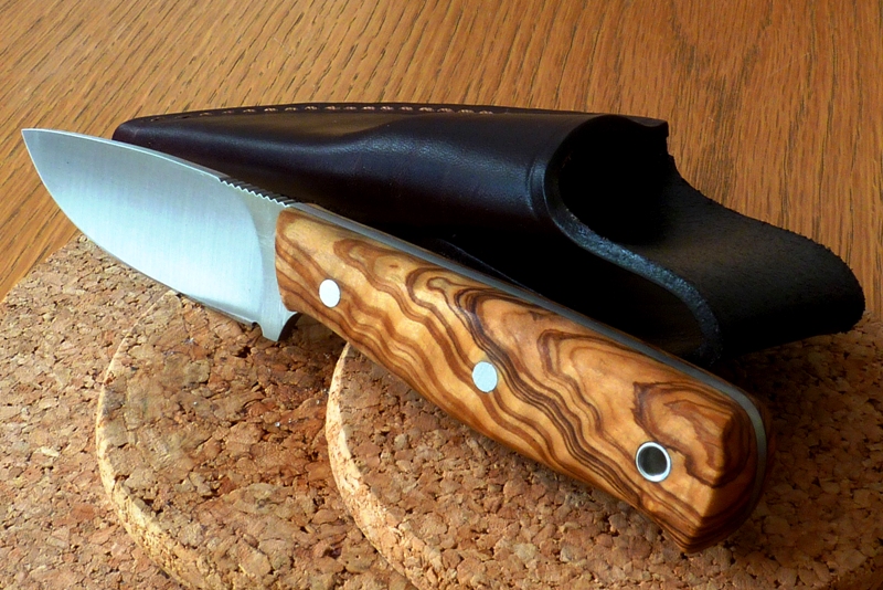

But a good piece of olive wood can be beautiful as well:
(not my knife or pic)
