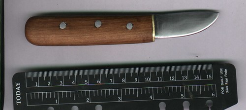

Here's mine. 1095, stock removal (hacksaw, files, sandpaper wrapped around things, etc), and handled with some American ironwood (Carpinus caroliniana, not the fancy stuff). It was a grafting knife.

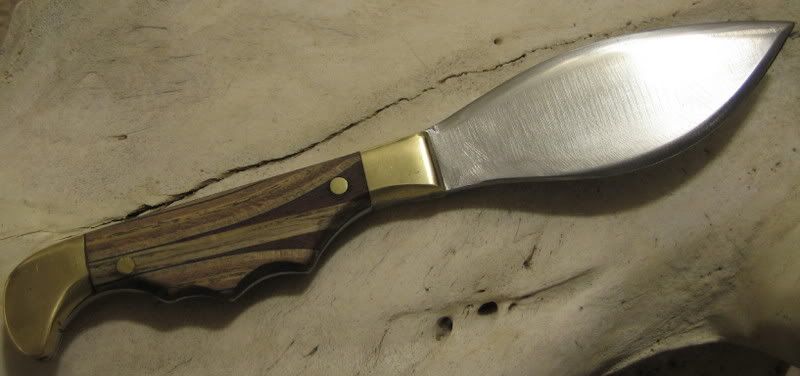

I started this one and about halfway through I took an "intro to knifemaking" class where we finished a knife during class. The knife I made in the class is well hidden, but this one came out pretty nice. I think since I started this one first, then technically, it's my first knife.
hand filed 1095
bocote handles with white liners
316 stainless pins, thong tube, and bolster
overall length - 7.75"

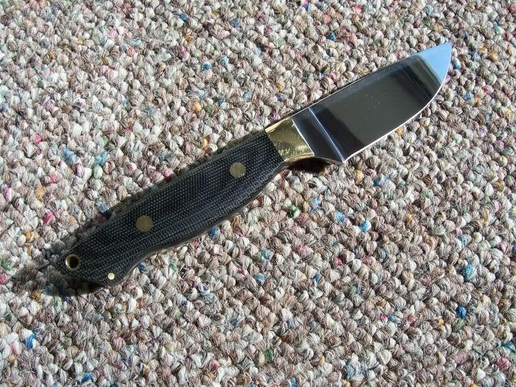

O1 tool steel, black canvas micarta handles, brass bolsters and pins. It got a home style cryo (acetone and dry ice). It has some use marks on the bolsters and handles now. I need to make a light box, bad. My second knife turned out alot better.
