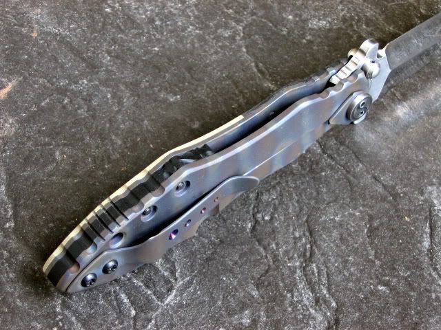

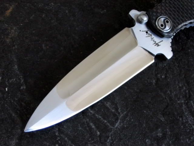

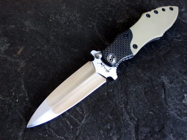

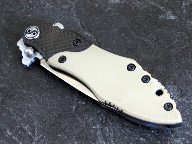

Hi all,
Long time never make the dagger! My new design "PRAN",
double flipper, complex grinding ( convex on tip and hallow on edge ), etc.
Spec. is
Blade steel : VG-10, Which's laminated with 410 stainless steel
Thickness : 4mm.
Blade length : 4 1/4"
Closed length : 5 1/8"
Opened length : 9 3/8"
Width : 1 9/16"
Handle : CF & Tan G-10
Frame : 6AL 4V titanium 1/8" thickness.
Frame stop : 6AL 4V titanium
Spacer/ Clip : 6AL 4V titanium
Pivot : Hardened 440C in Yin-Yang style.
Thanks for looking .:)
Yun
that knife is super awesome!:thumbup:
A very exciting piece! I love the ideas and mechanisms.
