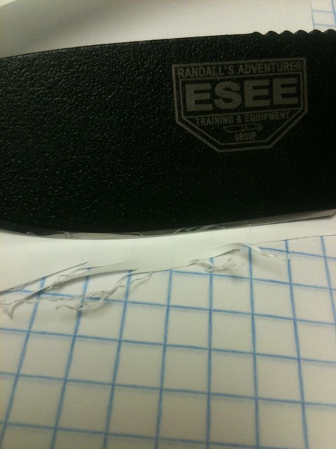

I spent some time with the Edge Pro on my RC-3 yesterday. Went up to the 6000 grit polish tape (2k & 3k on aluminum backers, 6k on glass,) then went after it with green-loaded and plain leather strops. It's reasonably sharp now, and kinda purdy too
push cuts paper curls with no problem at all
I haven't tried hair whittling, as my high & tight doesn't provide me with suitable fodder, but I'm sporting a bald spot along my whole left forearm after a single pass, and it'll do a bit of "tree topping" too. Shaves facial hair like a straight razor.
I can still see some fine scratches, though, so I need a little more time with the 600/1000 grit stones, I think.
