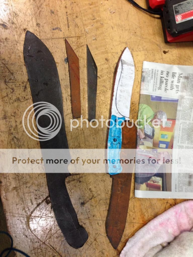

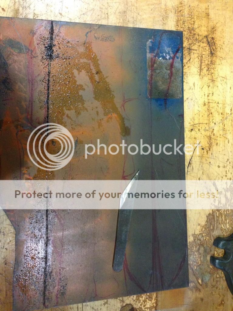

I know this is supet late in the game but just got my plate of Z-Wear and had more room then I thought so i cut out a chopper to play with. How did the Zwear chopper turn out? Every industry pro I taked to had a little different take but i figured I would test for myself. I understand the added carbon content but I think adding tungsten is also a good add or in my head it does. I know tungsten (i TIG weld) is very hard and wear resistent but brittle. I assume they do this to balance out the added carbon??
I am just a guy making what i want. No pro.
