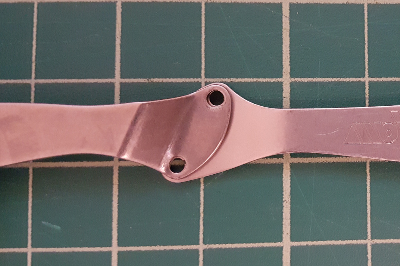

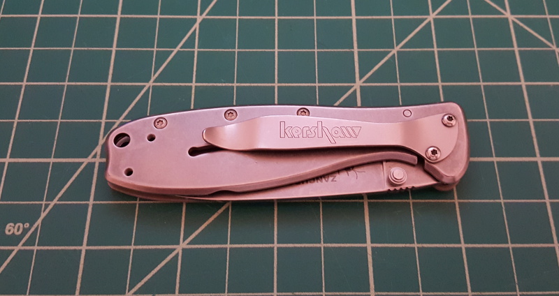

The hole spacing is the same, but they have different screw sizes. The diameter of the screws on the Zancudo are a bit larger.
A third party Leek clip should fit (you can re-use the original screws that came with your Zancudo), but you might need to enlarge the holes on the clip just slightly.
Here's the Zancudo with the clip from my Leek (using the screws from the Leek as well):
Here, you can kind of see how the holes on the Zancudo's pocket clip are a bit larger than the Leek's:
