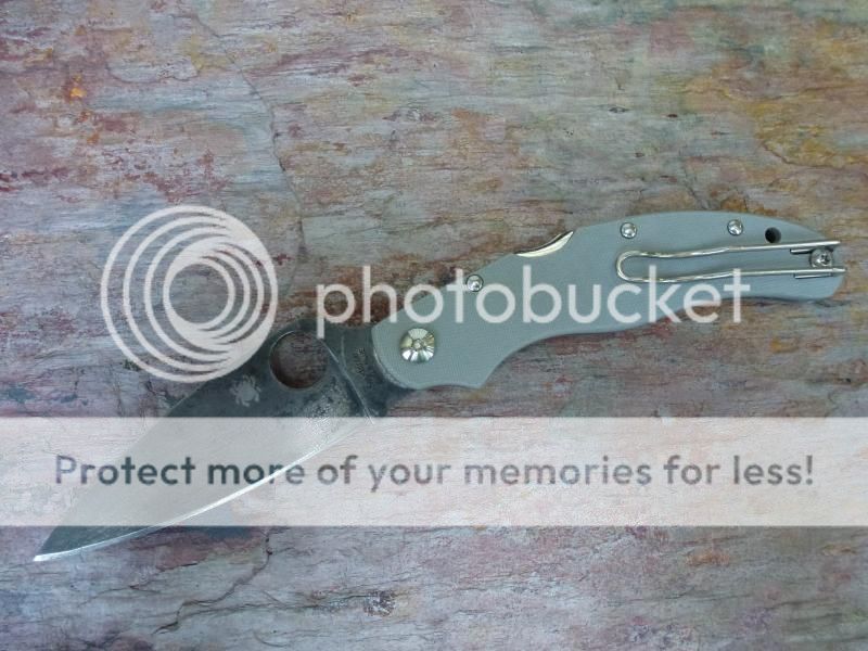

I have both steels, a Stretch in SB and a Caly 3.5 in ZDP. I really like them both. Hard to say which I prefer. The Suberblue is just a pleasure to sharpen and cut with. ZDP gets wonderfully sharp and seems to stay that way. I guess I'd recommend Superblue, but it's a tough call, they're both great.
Both are great steels to experience, but I would also recommend getting Super Blue while you still can at a reasonable cost. ZDP will hold an edge longer and is more corrosion resistant than Super Blue, but I am very fond of Super Blue and its properties. I like the looks when it patinas and how the edge seems to grab ahold of what it is cutting. The Caly 3.5 Super Blue might just be my all time favorite Spyderco.
