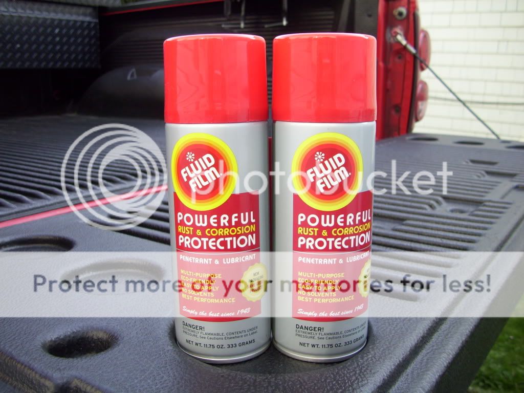

Google Fluid Film. Educate yourself. Magic in a can. Jack of all trades, master of many. It laughs at rust.
