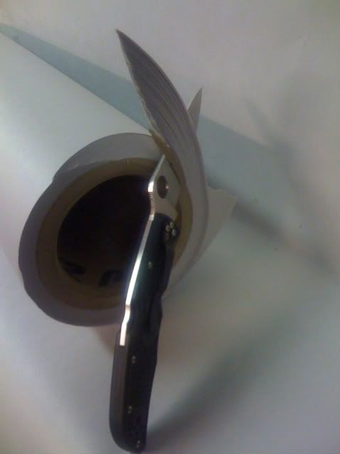

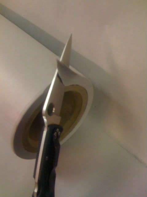

i am a newspaper printer , while i was at work last night i decided to do a few cut test with my FFG endura 4 ZDP . the cuts were done to some spent paper roll cores . my knife was sharpened to 6000 grit on my king stone and the total blade angle is about 35 degrees (17-18 per side) . i performed about 20 cuts and most were going into the solid glued core (brown center section) . i must say the ZDP held up extremely well , there was very little difference between the first and last cuts . when i use to do this with my VG-10 centofante 3 , the blade was noticeably duller after 5-6 cuts .
this was 4 progressively deeper cuts (plus the deep one behind the knife ;)) .

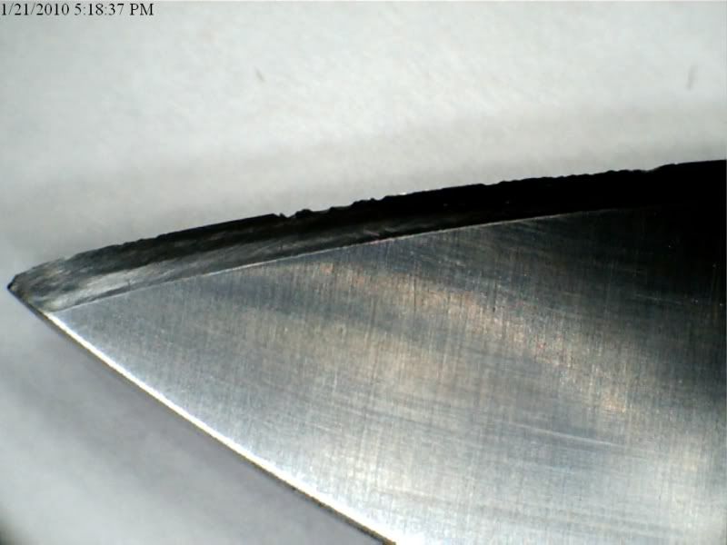

i recently used my ZDP endura4 to open the top of a coffee can and i noticed very small chips on the blade but nothing crazy for what i did , the ZDP held up pretty well . the knife was sharpened to 1200 grit (king stone) at 15-17 degree angle per side .
here's a pic :
