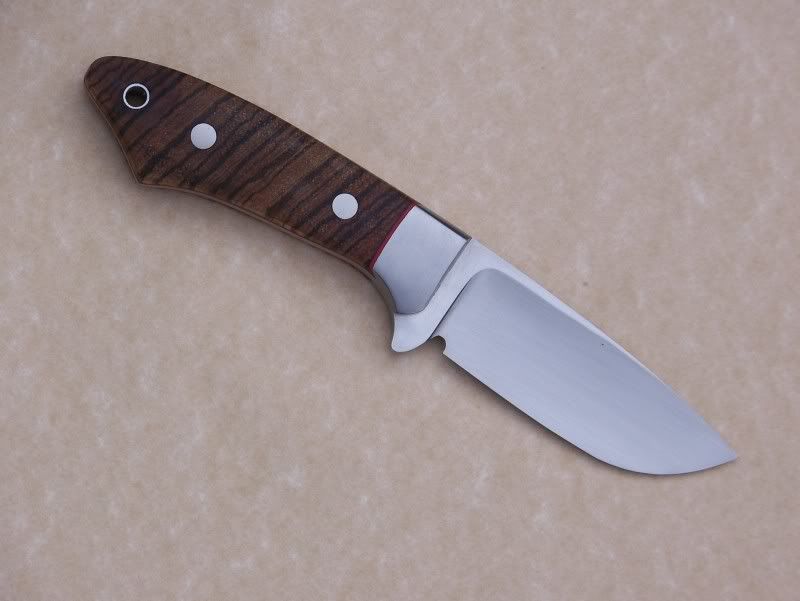

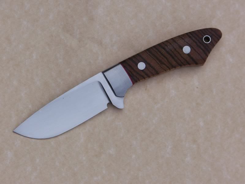

Just finishing another knife. This is end grain zebrawood, blade is 3 1/8 from tip to plung, with dove tailed bolsters, red spacers, and tapered tang, OAL 7 3/8"
I had some slow cure epoxy and let it soak till it started to set up, and wiped it off and thats how it turned out. End grain is pretty porous and the epoxy soaked right in the thin slabs. But I sending the rest of it out to be stabilized.
