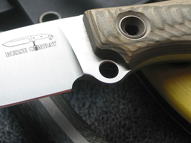

p.s. The picture above is borrowed from Rat Finkenstein at "Sticky: Nothing But Pics...." section.
Hope Rat will understand that I had to use it for some Busse knowledge. Nice sets of picture btw:)
The GW's are not ZG. You can see the sharpened angles. A zero grind looks flat right to the edge:thumbup:
