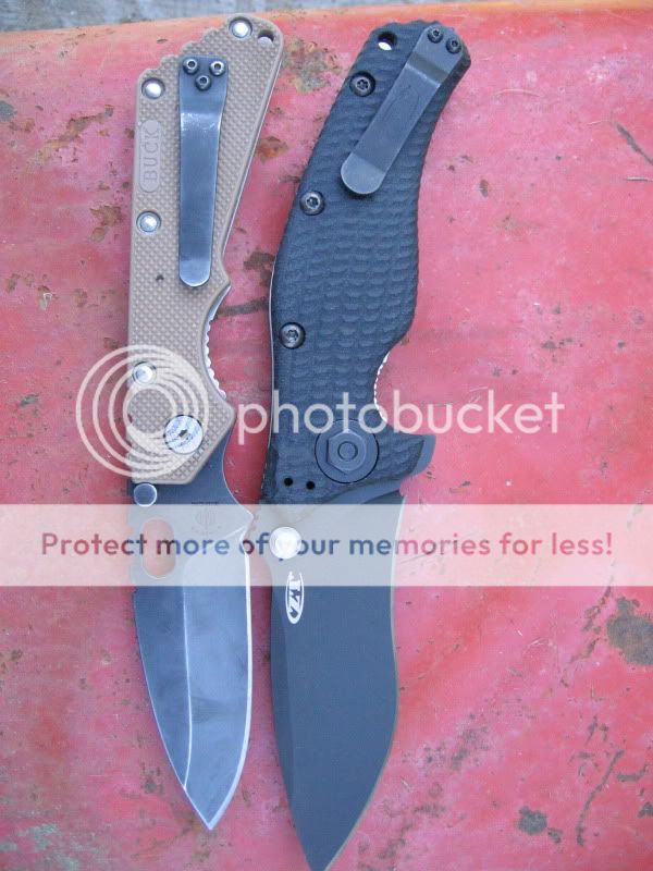

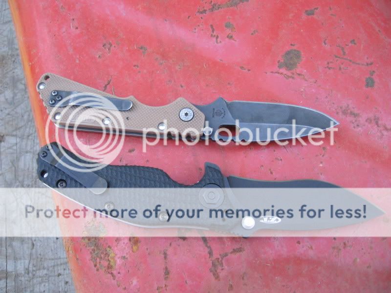

Last year I started carrying a Buck/Strider 889. I like the feel of the knife, it feels very sturdy and had a nice thick blade. I had a few problems right out of the box though
1. The liner lock didn't engage the blade in the middle more like the first 1/8. So I had to clean up the back of the blade a little so I took the time to polish the lock engagement area. This helped allot.
2. I could get a hair popping edge on the blade but no matter what angle I sharpened it to it would go very dull very fast:( No fixing that.
3. The bronze bearings for the blade were very gritty, I pulled the 889 apart and polished the bushings and oiled it up with some quality gun oil, but it still felt poor, no matter how loose or tight I set the pivot screw.

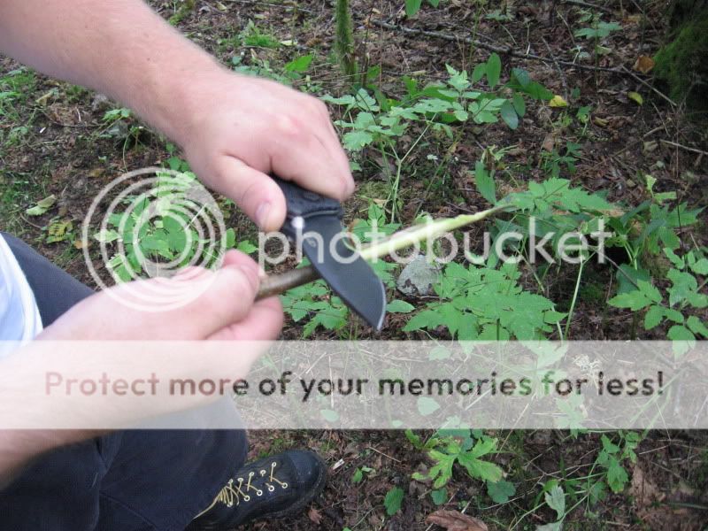

I sent camping this weekend up to the carbon river to our cabin, so I figured it would be a good time to test it out.

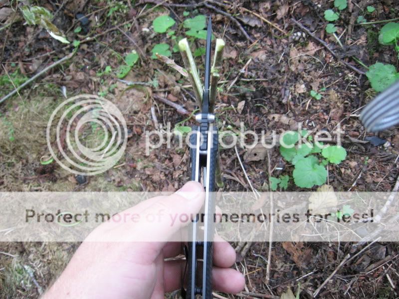

It worked very well carving very small sticks, here I was making some
marshmallow sticks:D

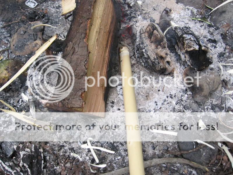

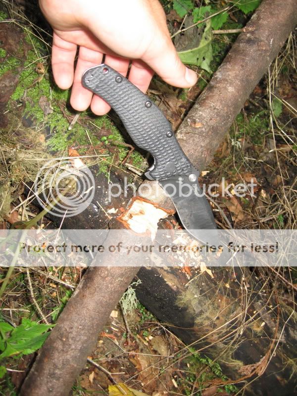

Here I was making a split hamburger cooker. So I battoned it through some maple and tied a wedge in the split.

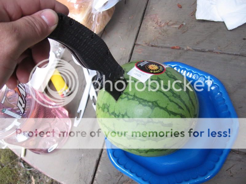

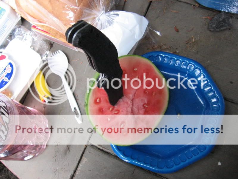

Works very well for small cooking stuff to, and makes short work of watermelon.
Screwed around a bit to see how well of a chopper it could be, very nice for a small folder. Any bigger of a stick would have been a pain though.

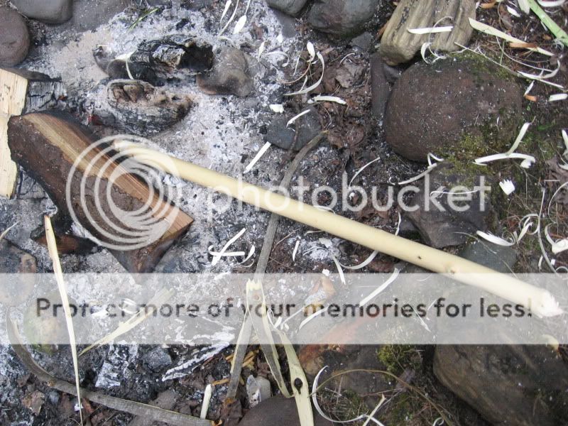

I decided I needed a rabbit club also
All in all I chopped and cut up
4 small 3in limbs
carved 6 marshmallow sticks
battoned through 4 pieces of fire wood for kindling
and carved handles in my rabbit stick

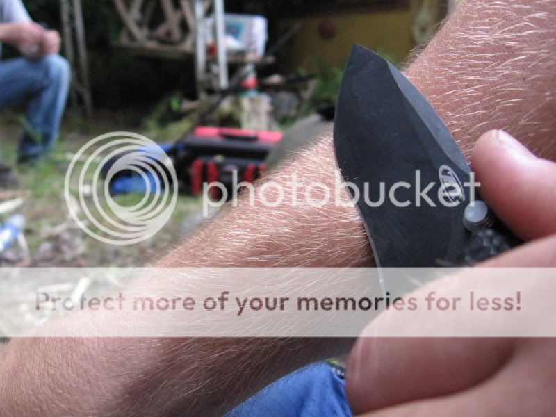

And it still shaved very well

interesting, but you compare two knives that are not in same category..
One is around 60 usd (Buck strider 889) the other is twice more expensive...
it would have been more fair to compare with the Buck Strider 882 (blade in ATS-34 = more or less 154CM) which is quite smooth in opening, and has a much better blade than 420HC steel:D
Anyway, your ZT 0200 look nice !:thumbup:
I wouldn't even put those 2 diff steels in the same league. 420:jerkit: It was all I had in about the same size folder to compare to.
